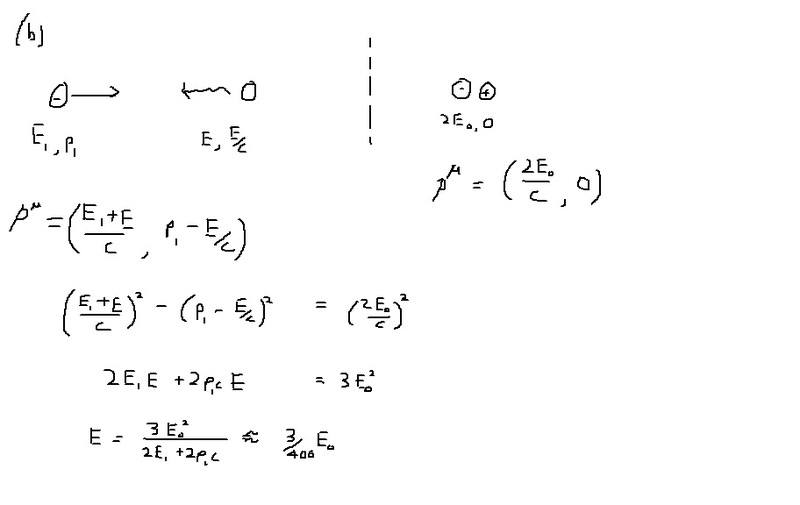

(b) In the lab frame, an utlra-relativistic electron with γ = 100 collides head-on with a photon of energy E. Find the threshold energy E required to create an electron-positron pair.

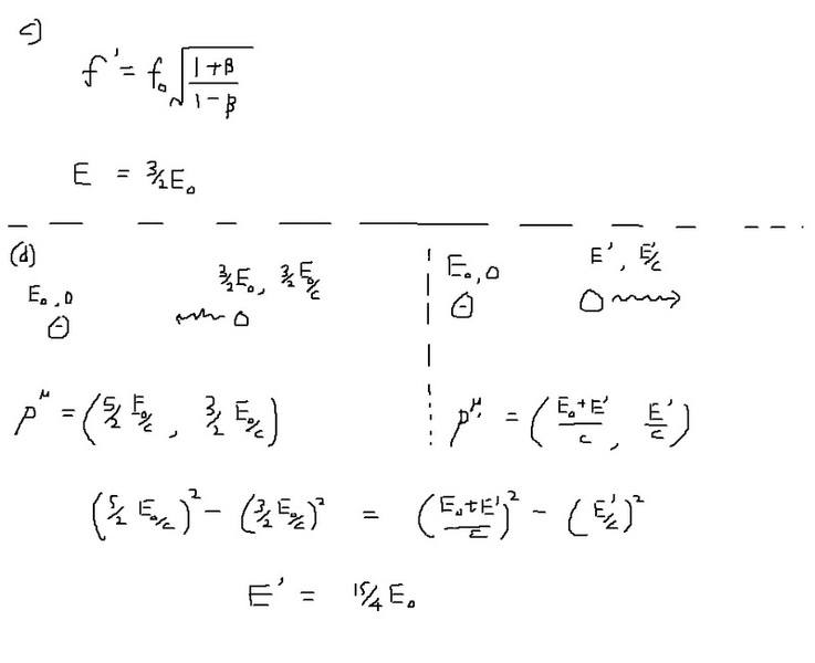

(c) In another head-on collision with the same setup, the path of the photon is reversed. Find the photon's energy in the electron's rest frame.
(d) Find the back-scattered energy of the photon in the same frame.

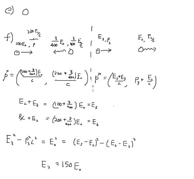

(e) Find the KE of the electron in the same frame.
(f) Find the back-scattered energy of photon in LAB frame.
Any help would be very appreciated!

Part (d): Is it alright to assume the electron remains stationary throughout the collision (Like a tennis ball rebounding against the wall)
Part(e): I'm not sure if this is a trick question, but in the elctron's frame, shouldn't it's own KE = 0?
