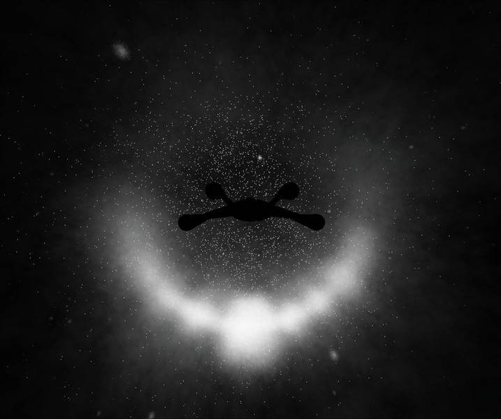

Real physics, ye cruel thing, you took away my starbow?
Then here is my starsmile, adherent fully to your code.
( Going perpendicular to the galaxy at 0.8c )
