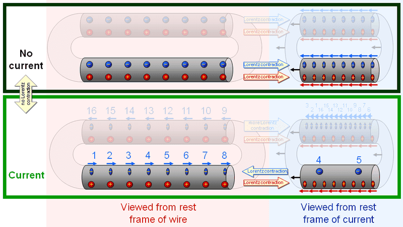

As others suggested, it's best to consider the entrie loop. Here is a great figure by @DrGreg:

Summing up, the source of my confusion seems to be that we must specify that it's the current-carrying wire that's electrically neutral — my assumption was wrong that if it's electrically neutral before the current starts, it'll also be electrically neutral after.
I'm not sure what you mean here. The assumption is that the wire is neutral with or without the current.
We are free to set this problem up any way we want. We could assume that the electrons bunch up once they are moving and then we have a different problem. You might argue about the physical process that would lead to such a configuration, but there is nothing electrodynamically invalid about that. You simply postulate a very long wire with more electrons than protons near the test charge. Perhaps simply that we had a charged wire in the first place.
The important point is that whatever the configuration is in the rest frame of the wire and although the configuration is different in another frame (in terms of E & M fields) it results in the same force on the test charge in all frames.
Duly retracted above. Thank you.
ETA: I've self-answered this below. Perhaps I even did it correctly this time.
As I noted, the diagram by @DrGreg is excellent and clears up my earlier misunderstandings in this thread (and other threads like it). Thank you, @A.T. There's one thing I don't understand, though: Why are only two electrons shown in the lower-right case? Seems like the shape and spacing of the electrons (in the diagram) should be the same as in the upper-left case, since the electrons are at rest in both frames.
However, maintaining such spacing creates a problem between the lower-left and lower-right cases.
What is the explanation for the spreading-out of electrons from the upper-left to lower-right cases, since in both cases the electrons are seen as being at rest? I realize these are physically different situations and you cannot simply transform between them, but I can't get past the idea that the same electrons are seen as being at rest in each case, and yet their spacing is seen as different.
The only difference between the upper-left and lower-right cases seems to be that in the latter, the positive charges are moving to the left. Everything else is the same. Surely this can't be responsible for the electrons spreading out.
A.T. said:
Okay, so, I've been reading PF posts on this topic for several days now. Everyone seems to have the same confusions as I did. But I think I can now answer my own question above, as well as others:
When the current is on, the electrons do length-contract in the wire frame (bottom-left). Their separation would also length-contract, except that we've specified the boundary condition that the wire is uncharged, and there remain the same number of electrons in the loop as without current, so necessarily the electrons must remain at the same separation and charge density. However, in the co-moving frame (lower right), the electrons and their spacing un-contract — and thus the initial boundary condition results in a lower charge density than exists in the no-current/wire-frame case (upper left). Perhaps one could say that when a current is applied, the electrons acquire a greater proper length between them, which becomes apparent in the co-moving frame. This manifests as a positive charge on that side of the wire.
This also answers why a straight wire uncharged in the lab frame, for example, doesn't spontaneously acquire a charge due to electron length contraction when the current is switched on. With the current, every electron leaving an arbitrary region of the wire is replaced by an electron entering at the other end of the region. They don't contract closer together, the reason for which becomes clear when the wire is a loop.
Finally, this answers the inevitable question of why the test particle doesn't experience zero electrostatic force only when it is moving at half the velocity of the electrons (in which case, in the test particle's frame, the electrons and + nuclei are moving at the same speed in opposite directions). The electrons and the nuclei don't enjoy the same freedom. The electrons can move around; the nuclei can't. This breaks the symmetry. Electrons and their distribution conform to the boundary condition of 0 net charge by acquiring a greater proper distance between them, but the nuclei cannot do this.
Did I get all of that right?

This question is a simpler version of the always recurring question:
"How to explain Magnetism as a relativistic side effect of the Electric Field"
The answer to the OP's question:
- A test-charge at rest is only subject to an Electric Lorentz force.
- In the rest-frame the Lorentz force is calculated by integrating over all relativistic transformed Electric fields.
- Charge is Lorentz invariant. A wire with an equal number of negative and positive charges has a net charge of zero
- The Electric field of a moving charge changes under Lorentz transform.
- But the integral over all Lorentz transformed electric fields of all electrons in an infinitely long straight wire does not change regardless of the velocity of the electrons as long as the electron density in the wire stays the same. (The relativistic calculation is http://www.physics-quest.org/Magnetism_from_ElectroStatics_and_SR.pdf in section 2)
- Electrons move in principle independently from each other through the wire. The electron density is therefore not necessarily subject to Lorentz contraction. The field of each individual electron is transformed but the electron density is in principle arbitrary. The wire is neutral if the electron density is the same as the positive charge (proton) density.
This why the test charge at rest in the lab frame does not experience a force from a neutral current.
Also note this logical fallacy: The drift-speed of electrons is spread over a wide range of different velocities and the speed of each individual electron changes all the time. A Lorentz contraction of the electron density based on some average electron velocity makes no sense.
Next:
Explain the Magnetic Lorentz force on a test-charge moving in parallel with a neutral current carrying wire. The by far simplest way to explain this (using pure electric fields) is non-simultaneity and going to the rest-frame of the test-charge- In its rest-frame the test-charge is only subject to Electric Lorentz forces.
- Due to non-simultaneity one end of the wire lays in the future and the other end in the past
- Therefore a net current has streamed into (or out from) the wire when viewed from the rest-frame of the test-charge.
- The wire is thus not electrically neutral anymore in the rest-frame of the test-charge
- The integral over all electric fields gives us the non-zero Lorentz force. (See http://www.physics-quest.org/Magnetism_from_ElectroStatics_and_SR.pdf in section 1)
we can also calculate the Lorentz force on a test-charge moving perpendicular to a neutral current carrying wire by integrating over all electric fields as seen in the test-charge's rest-frame. (Again http://www.physics-quest.org/Magnetism_from_ElectroStatics_and_SR.pdf in section 3)
A detailed derivation of the Lorentz transform of the Electromagnetic Potentials and Fields can be found here in my book:
http://www.physics-quest.org/Book_Chapter_EM_LorentzContr.pdf
following the original work of Liénard and Wiechert in 1898-1900.
