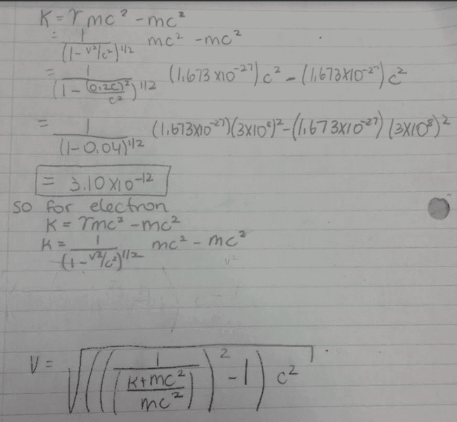

A proton has a speed of 0.2c. Find the speed of an electron that has (a) the same kinetic energy as the proton, and (b) the same momentum as the proton.
K=ϒmc^2-mc^2
This is what I did for the same kinetic energy part, but I would end up with a negative under my square root. I found the formula in my notes, I'm not really sure what to do but I tried something. Can anyone offer me some guidance? I have not attempted the momentum part yet
You are OK all the way up to your final expression for v. You made a minor mistake in solving for v. Check your work to see if you can find the mistake.
Also, you can rearrange ##\frac{1}{\frac{K+mc^2}{mc^2}}## to a simpler fraction.
It will be multiplied by a negative c ?
Sorry, but I'm not sure what you are saying here.
My mistake was that when I solved for v I forgot the negative sign
Yes. Good.
TSny said:
Yes. Good.

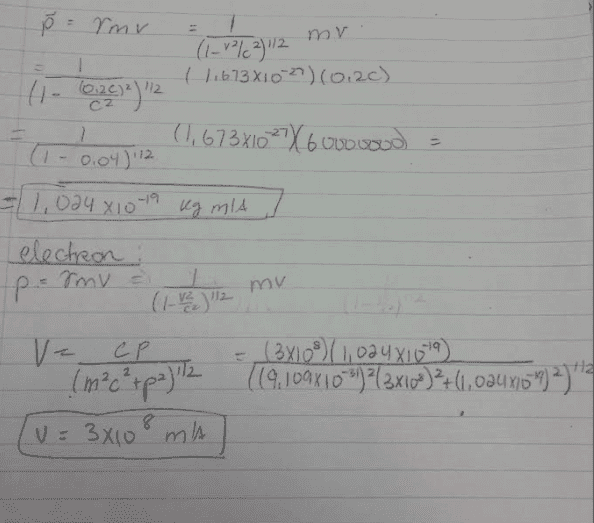

This is what I did for when they have the same momentum
It just seems weird that it gives me the speed of light I feel like that's probably wrong.
Looks good, but if your calculator is accurate enough, you should find that the answer for v is slightly less than c.
Ok, it was a bit less but I rounded it. I could right the exact answer
