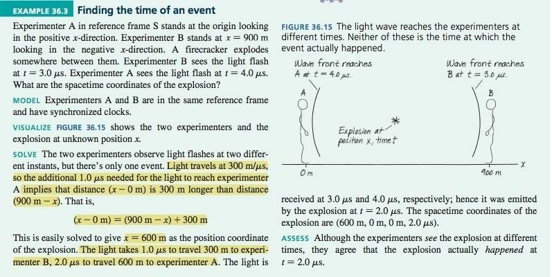

For the problem below, I understand how to solve it using numbers, but I am having trouble understanding the physics/logic behind the solution. More specifically, I do not understand how the time of seeing the light flash is different compared to the actual arrival of light. Any assistance would be very helpful. Thanks.
Experimenter A in reference frame S stands at the origin looking in the positive x-direction. Experimenter B stands at x = 900 m looking in the negative x-direction. A firecracker explodes somewhere between them. Experimenter B sees the light flash at t = 3.0 ms. Experimenter A sees the light flash at t = 4.0 ms. What are the spacetime coordinates of the explosion?

S is the standing reference frame for which both Experimenter A and B are within. I will post the solution to the problem below in (.jpg format). Hopefully this will help clarify my concerns.

ok, so light would take 3 µs to go from A to B
so if the flash takes a µs to reach A and b µs to reach B, then a + b = 3
and also a - b = 1 (because when the flash reaches B, it stil has 1 µs to go before it reaches A)
so a = 2, b = 1 :smile:

so since the question tells you that the time on the clock when it reaches B is 3 µs (and for A, a = 2 µs, and the arrival time is 4µs), that means it must have started at 2 µs

I apologize for the copy and paste mishap. From my understanding the time on the clock that the light reaches Experimenter B is 3 µs, but the actual time of travel for the light is 1 µs (making the time of the incident at t=2 µs). The 3 µs is almost like a "false time". Does that look correct?
yes that's correct :smile:
the flash happens at 2, the light takes 1 to reach B at 3, and 2 to reach A at 4
