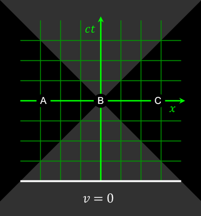

I am not 100% sure that I understand what you are asking. However, it seems that you have some concern about an extended object and how the relativity of simultaneity affects extended objects.
If so, then I think that it is important to understand the geometry of relativity. The geometry of relativity consists of a 4 dimensional spacetime which includes the usual 3 dimensions of space and the usual 1 dimension of time, but together in a single 4 dimensional "manifold".
An "event" is a single point in spacetime, i.e. something that happens for only an instant and only a single location requiring 4 coordinates to identify. So there are no "parts" of an event. In a sense events are "parts" of other things.
A point particle exists at a specific location at any instant in time, so in spacetime this corresponds to a line, called a worldline. The different "parts" of a particle's worldline are different events along the worldline. E.g. the particle colliding with another particle could be one event etc.
An extended object exists at multiple locations at any instant in time, so in spacetime this corresponds to a "worldsheet" or "worldtube". Different simultaneity conventions consist of different ways of grouping the events that make up the worldsheet into events which occur at the same time. However, none of the physics depends on those groupings.

This is actually not correct--at least, what I think you mean by it is not correct. But rather than try to deconstruct it, let me state what I know to be correct, and then you can compare.
Here's what I know to be correct: suppose the car is 10 feet long, and suppose the steering wheel is attached at one end. (This is a special experimental car design :wink:.) Light travels at 1 foot per nanosecond, so suppose that, in the frame in which all parts of the car are at rest, the event of the steering wheel being attached happens 5 nanoseconds after the event(s) of the rest of the car being assembled.
In other words, we have two coordinate times of interest in this frame: t = 0, when all the pieces of the car except the steering wheel are assembled and are simultaneously at rest at x-coordinates from x = 0 (the steering wheel attachment point) to x = 10 feet; and t = + 5 nanoseconds, when the steering wheel is attached at x = 0. Call the event of the steering wheel being attached event S; call the event at t = 0, x = 0 (the assembly of the steering wheel attachment point) event O (the origin of the frame), and call the event at t = 0, x = 10 feet (the assembly of the far end of the car from the steering wheel) event E. Also we'll label the event at t = 0, x = 5 feet (the assembly of the midpoint of the car) event M.
Given the above, the following will be true:
(1) In the car's rest frame, events O and M and E are simultaneous, and event S happens after events O and M and E. (This should be obvious by inspection of the coordinate values I gave above.)
(2) There is a frame in which event S happens before event E; in other words, in this frame, the steering wheel gets attached before the far end of the car is assembled. (This follows from the fact that events S and E are spacelike separated: and *that* follows from the fact that I set up the time interval in the rest frame, 5 nanoseconds, to be smaller than the space interval, 10 feet, divided by c; in other words, the space interval is 10 light-nanoseconds, and 10 > 5.)
(3) There is also a frame in which event S is simultaneous with event E. (This follows easily from #1 and #2 and the continuity of the Lorentz transformation.)
(4) There is *no* frame in which event S happens before event O; in other words, there is no frame in which the steering wheel gets attached before its end of the car is assembled. (This follows from the fact that events O and S are timelike separated, which is obvious from the fact that in the car's rest frame both events have the same space coordinate, x = 0, but S's time coordinate is later than O's.) There is also no frame in which event S is simultaneous with event O, for the same reason.
(5) There is also *no* frame in which event S happens before, or is simultaneous with, event M. In other words, the attachment of the steering wheel *must* happen after the assembly of all of the front half of the car, in *any* frame. Only the assembly of the rear half of the car can have its time ordering relative to the attachment of the steering wheel changed by a change of frames. (This is because events S and M are null separated; a light ray emitted towards the front of the car at event M will pass through event S--it will be seen at the front of the car at the same instant that the steering wheel is attached.)

Let's consider a car that is 10 feet long and stationary in an Inertial Reference Frame (IRF). (Don't confuse this car with the one Peter Donis proposed in an earlier post.) The front of the car shown in red is at a distance of 10 feet from the spatial origin and the rear shown in blue is at the spatial origin:
https://www.physicsforums.com/attachment.php?attachmentid=58389&stc=1&d=1367415325
Please be aware that there are solid parts of the car everywhere between the blue and red lines but if we filled them all in it would look like a solid block of color and make the next drawing harder to understand.
Now we want to see what this car looks like in a frame where it is traveling forward. To do that, we use the Lorentz Transformation process with a negative speed, in this case -0.6c, which will make the car go forward at 0.6c in this second IRF:
https://www.physicsforums.com/attachment.php?attachmentid=58390&stc=1&d=1367415325
I believe your concern is that the parts of the car, specifically the front and rear, are no longer simultaneous so how do we make sense of this? You are right, and the way we make sense is to view the car in the new frame with its own sense of simultaneity which is established by the horizontal axis lines. So we can see that at the coordinate time of 10 nanoseconds, the front of the car is at the coordinate distance of 14 feet while the rear of the car is at 6 feet making the car 8 feet long, contracted to 80% of its rest length.
As one justification for doing this, we can take those coordinates and transform them back into the original IRF and we see that they will be at the Coordinate (and Proper) Times of 2 nanoseconds for the front (red) end of the car and 8 nanoseconds for the rear (blue) end of the car. Even though these events are a different times, it won't matter for the measurement of the length of the car (with a ruler) in its stationary frame since the ends of the car are not moving relative to each other.
There are other justifications for establishing the contracted length of the car when it is moving and they all agree.
Does this make sense to you? Does it address the issue you are concerned about?
