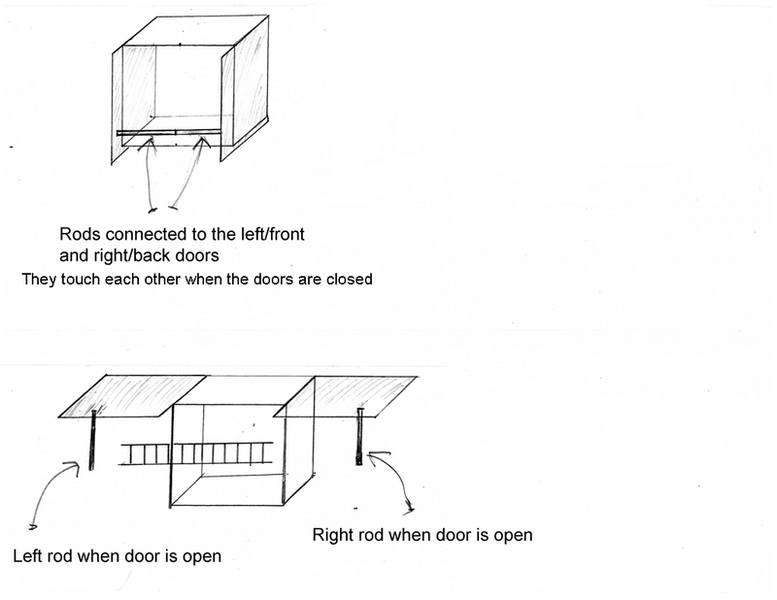

A third simultaneous event is introduced in the ladder paradox, by attaching a rod to each door, which are welded perpendicularly on the inside of the doors, in a way that both rods touch when the doors are simultaneously closed (the small added red lines on the graphics)
(The rods are not on the way of the ladder, and can be placed in a way not to touch the floor.)
The single event "touching of the rods" verifies that both doors are closed simultaneously.
touch - simultaneity
no_touch - no_simultaneity
In the same time as a single event it must be present in both frames of reference.
As seen on the left graphic (garage frame of reference with shorter ladder), the rods touch in the frame of the garage, when the doors are closed.
As an event, it should be present in the ladder frame of reference, but it is not.

Again! You are treating the rods as rigid which they cannot be. How many times do we have to repeat this?
Your diagrams are wrong because you continue to ignore the above. You either have to learn the maths and prove this for yourself (I recommend this) or take our word for it.
No, I'm not.
I repeat my answer from the locked topic:
note that while the end of the back door rod departs later from the point of the touch, the left rode will arrive later too, thus missing the touch, for the single fact, that the front door need to give time for the ladder to pass through.
Also, as stated in the OP "the first event is the front of the ladder approaching the exit door of the garage.
The door closes, and then opens again to let the front of the ladder pass through.
At a later time, the back of the ladder passes through the entrance door, which closes and then opens."
The above leaves no time for the touching event.
The diagrams are not mine except for the added rods. They are widely accepted and published in Wikipedia.
Please let us know at which point the touching event will happen.
Yes. You added the bit that's wrong... Try adding in the delay in the rods' movement due to the finite speed of sound in the rods.

There is no rotation here.
For your reference, here is how the rods look from closer view:
The rods are pointing to 3 o'clock and 9 o'clock in your first picture and to 6 o'clock in your second picture. There is rotation...
You again display the same fundamental misunderstanding as before and refuse to accept correction. This thread is therefore closed. I suggest you read and try to understand the implications of the replies you have received.
