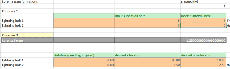

Also, I've simualated the Einstein thought experiment now in a spreadsheet and it does the Lorentz transformation to show what obervers B should conclude; I'll share a screenshot of it next after I know I've got the formula correct first!
thanks
