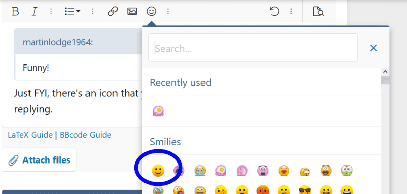

Just FYI, there's an icon that you can use that saves you the time of replying. Also, the "like" button gives you choices immediately.
