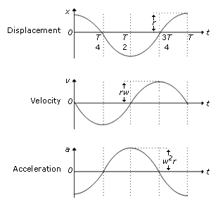

I'm of very little help on the relativity aspects of your question, but I think I can point out a misconception that you have about accelerated motion that may be contributing to your not accepting what you are being told by these very experienced physicists. When an object is oscillating back and forth, the only places where the acceleration is zero (briefly) is at the the midpoint of the oscillation. At the extremes (like when your two thought experiment people touch), those are the maximum acceleration points. That is why the frame is not inertial when they touch. I will try to find a basic tutorial about acceleration in oscillatory motion to help you understand the other replies that you are getting. :smile:
EDIT/ADD -- Like this:
Likes PAllen
