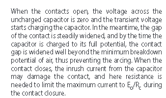

davenn said:
that's not going to solve the relay contacts from sticking :wink:
?? Inductive load so arcing is when contact opens.
http://www.panconcorp.com/PDFs/capacitors/QRL-Quencharc.pdf
davenn said:
Anyway, I don't see what putting a diode across the contacts would do, as he suggested
Agreed 100 % .

Omron Relays at archive.org have plenty of arc-snubbing advice for relay contact opening. Since ionization can occur at very small gaps as it opens and only takes a microsecond or so, the rate of change is not fast enough to prevent an arc . Also the travel distance is kept small ( few mm) to reduce "Make time" but "Break Current" is gap and inductive current dependent just like holding current in SCR's. But with dry contacts you have very small capacitance reducing as it opens which leads to high voltage (kV) as it opens, V=L dI/dt as dt goes to < 1 us with < 1 pF gap.
The most popular snubbers for low power DC contacts are diodes clamped to the opposite rail. But the low diode resistance also causes slow switching times due to Tau=L/R. So using MOV's or Zener's speed up and quench the switching.
SeriesRC snubbers are also popular for motor relay contacts. This can be in the form of discrete components or very lossy film caps to limit the currents and also prevent arcing from 1kV/mm average air breakdown, but the R value must be damping the resonance as well as limiting contact burnout currents where the highest voltage drop occurs across the highest impedance in the loop..
