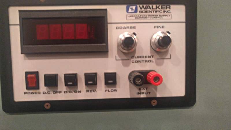

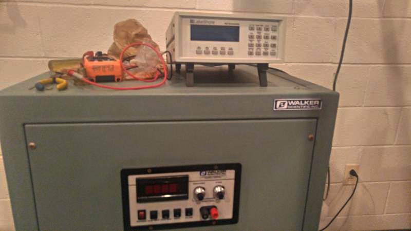

Hello and good day.

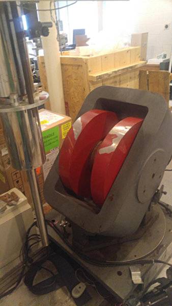

I am currently involved in research that seeks to utilized a Walker Scientific power supply and magnetic. The system is old but functional. We seek to utilize the magnet in order to conduct some low temperature experiments. We need information on this power supply, of which we have very little info available. I have contacted relevant persons at Walker Scientific here in the U.S. However, I have yet to receive a follow response from them.

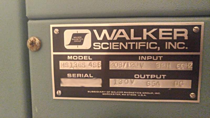

It's a very large, green power supply, whose model number is HS1365 4SS. Specifically, we would like to control this magnet remotely via it's power supply. This may be a long shot, but is there anyone here with such experience in utilizing large magnet system such as these. I would much appreciate any useful response.
We are looking at using the external input(Ext. Input) on the front control panel to achieve this, however we do not know what the input control voltage specifications are.
Anyone?

If you can't find any specifications on the external input, you could try treating it as a black box and see what happens. What happens when you put 0 Volts across the external input? How about 0.1V? 0.5V? I can't see low voltages like these damaging the supply. Maybe you can characterize how it works. Just a guess, but one would think that the power supply current would be proportional to the external input voltage.
Thank you phyzguy. We thought about that, and if given no choice then we will do just that. But we would prefer to spend the majority of time we have, in doing experiments. Not that I think it would take a lot of time (maybe!). But I guess sometimes you don't have a choice.
Thanks again.

BTW, is the output DC or AC? Do you have an idea of the range of voltages and currents that big thing can put out? That's a big magnet!

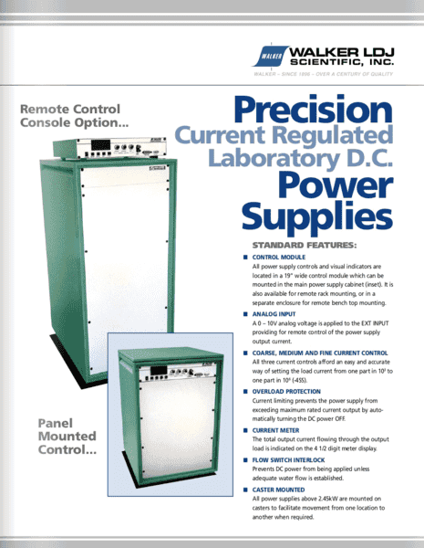

I found this on Google. Not exactly the same unit, but it says the External Input is a 0-10V input that controls the output current. I'm willing to bet the unit you have works the same way. Try what I said in Post #2.

I have done the same. No luck with google. Output is D.C, 130 V, 65 A.
