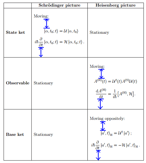

I have created a table which has some equations in it. The LaTeX code is as follows:

The code renders as shown below:
As you can see, there is a lot of extra vertical space around the align* environments, which I have marked with blue arrows. How can I remove this space?
The lengths you need to set are
Code:
\abovedisplayskip
\belowdisplayskip
\abovedisplayshortskip
\belowdisplayshortskip
Likes Wrichik Basu
@pasmith Thanks. Setting those lengths to 0pt reduced the spacing to what is normal. This is how it looks now:
