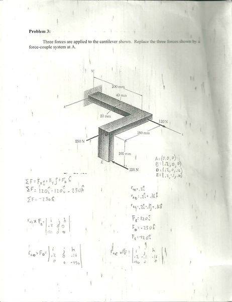

Replace the three forces shown by a force-couple system.

As you can see I already solved for the force part of the problem. What I'm having trouble with is what to do with the 40mm and 20mm of the problem. Do I even have to included it in the problem. If so where do I. Do I have the right step up for the couple part?
help .
