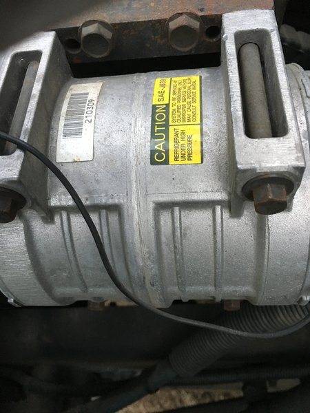

Hi all,
I have a little project on my hands and I will go into a little detail to help everyone better understand. I built a mobile boutique out of a shuttle bus for my fiancé to run her business out of. There is a large rooftop air conditioner on top of the roof for cooling and the compressor is ran of the diesel engine. In our application that doesn't work the best because the motor is usually of when the air conditioner is needed. I would like to power the air conditioner compressor with an electric motor. I already have a 12VDC inverter large enough to run all the air conditioner equipment except for the compressor. I would like some help sizing the electric motor needed to run just the compressor - i have attached a chart (via hyperlink) with what I think would be needed to size the motor. I know a couple things would important - RPMs, HP, and motor pulley size - the pulley size on the compressor is 5.3 inches in diameter.
ovrewjnk1
https://postimg.org/image/ovrewjnk1/
Is the compressor usually powered electrically? If so, I don't understand the point of the electric motor.
No it is normally powered off the diesel bus motor.
Does the bus engine do something else too? What?
Couldn't you just negotiate to have the engine run when you want A/C?
The problem is when we are selling at vendor events we are not allowed to run a Diesel engine, we can only use shore power or in some cases a generator. Instead of adding a rv air conditioner i can plug in I would like to utilize what I have because it works so good, only problem is that you need the engine running which isn't allowed.

What type of AC unit do you have? What are its specs?
The compressor is a Sel-Tec TM-16HS. I attached a chart via a hyperlink to the first post with what I think would be helpful.

I tried to google for data on the compressor but couldn't find much. Is TM16 a standard size of compressor? If so then there is some performance data in here...
http://www.valeocompressors.com/media/brochures/TM13-15-16.pdf
The performance curve for TM16 suggests the compressor would consume between 1 and 5.5kW depending on the rpm. Picking a point in the middle somewhere gives:
3.3kW at 2000rpm
Your inverter might be able to deliver 3.3kW but how about your battery? If we assume it's a 24V system the current draw is going to be around 135-140A.
How long do you need it to run for? An 8 hour day?
137A * 8H = 1000AH but in practice you should probably double that to avoid deep discharging the battery. Big battery needed and better think how you will recharge it if you need to do the same next day.
As for the motor I'm thinking you would be looking for something like a >6HP (4.5KW) single phase 110V AC motor rated at 2000 rpm (or different rpm and suitable pulley ratio to produce around 2000rpm).
Motor may need a cooling fan if not fitted.

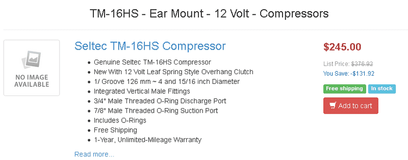

I like the idea of reusing what is there, but I'm skeptical that this can be done cheaper and easier than alternatives. Is there any salvage value to the present unit?
new one costs about $250 US
so a good used one ought to bring 50 to 75 bucks
