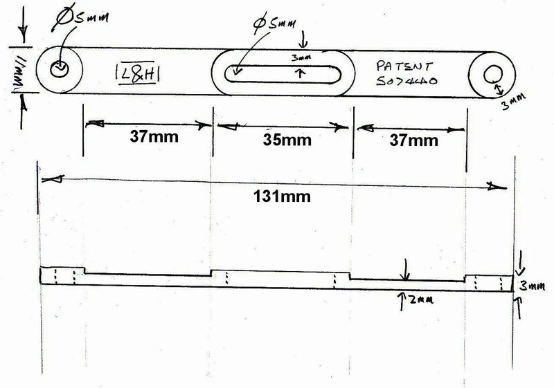

I am really struggling with a 'materials' issue and hope someone can help me solve my problem?

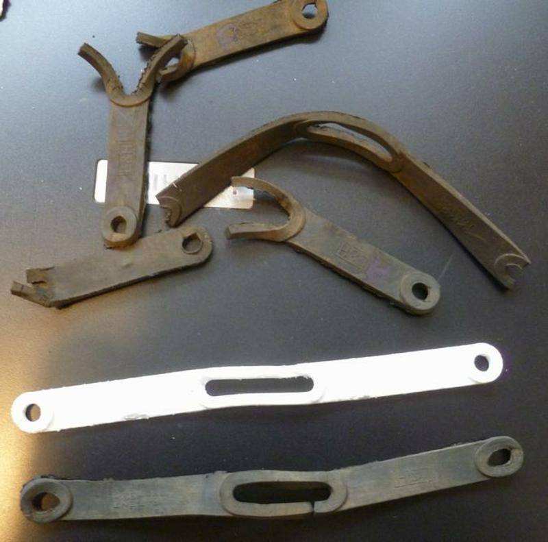

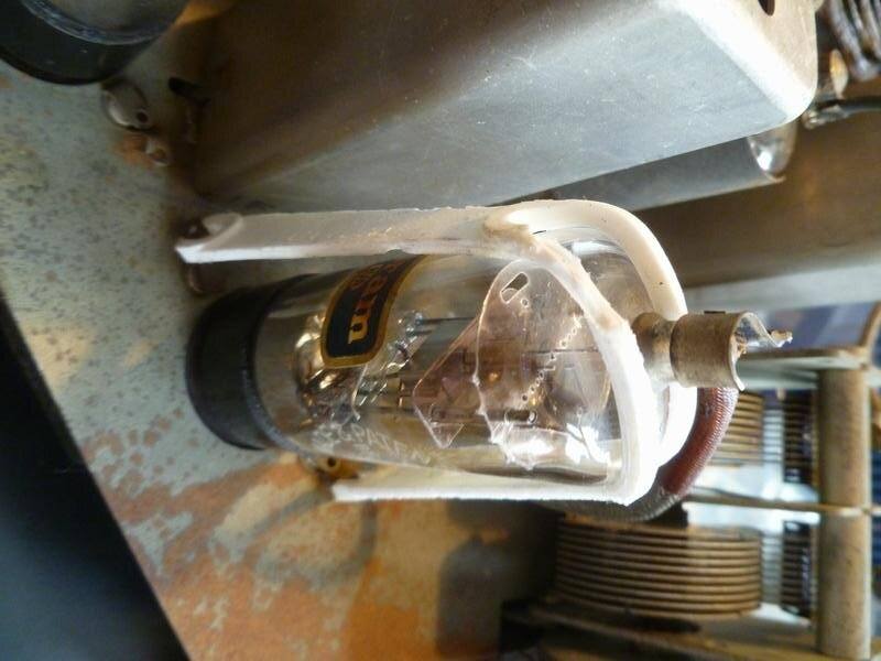

I have a 1930's portable valve (tube) radio that has black moulded rubber valve retaining bands.
These are quite firm (but stretchy) rubber that have holes at each end to hook over lugs either side if the valve holder.
Stretched over the top of the valve they firmly hold the valves in place, with a slit in the centre for the 'top cap' of the valve to protrude through.
These rubber retainers are all perished and useless and I have been attempting to make replacements.
I have tried 3D printing with alleged 'elastic' filament, I have printed a 3D mould and tried various silicone rubber compounds.
The results have been either too hard (and not elastic at all) or too soft and split when under tension.
What I need is a way to engineer original vulcanised rubber to produce a material like bicycle / car tire inner tube.
The difficulty is I need to mould it as the holes at each end and the slit in the center has a thicker reinforcing annulus.
(See attached)
I have scoured the web and failed miserably to discover how to reproduce DIY moulded vulcanised rubber. I can make the required aluminium mould, I can make the heater but where do I get/ how do I make the moulding material?
Thanks in anticipation.
Dave

The flexibility of the finished straps have to be similar to a strip of bicycle innertube or thick elastic band. Strong, stretchy and black.
As you see from my pictures they are most likely Vulcanised India Rubber and my reproductions have to look concourse. My restorations have to end up looking as original as possible as some of these wireless sets may be the last surviving example. My reproductions must have the correct shape, elasticity and include all the inscribed lettering that is on the originals (patent number/manufacturers logo etc)
I have seen that there is a process called 'compression rubber moulding' in which an 'ingot' of uncured rubber is compressed under heat into a mould, forming the required shape and 'curing/vulcanising' the rubber in one operation.
This is most likely how these were originally manufactured I just need an expert who can tell me the secret 'spell' to DIY this operation :-)
Thanks
Dave
