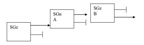

Given the series of three Stern-Gerlach devices:
Represent the action of the last two SG devices as matrices ##\hat{A}## and ##\hat{B}## in the ##|+z\rangle, |-z\rangle## basis.
##|+n\rangle = cos(\frac{\theta}{2})|+z\rangle + e^{i\phi}sin(\frac{\theta}{2})|-z\rangle##
A Stern-Gerlach device with one beam blocked off can be represented as a projection of the incoming state onto the outgoing state. A projection operator can be written as the outer product of the selected basis state with itself, e.g. ##|+z\rangle\langle\,+\,z\,|## would be the projection operator for an SGz device with the minus size blocked.

Should this be equal to the given ##|+n\rangle##?
I feel as though I'm missing something completely obvious or misunderstanding the question.
Thank you for any help you can provide.

Hello and welcome to PF!
Yes, the output of SGn should be |+n>, up to a normalization factor.
So would ##\frac{1}{cos(\frac{\theta}{2})}## make for a suitable normalization factor? Is there a more formal way of determining this normalization factor?

Not that I can think of at the moment. The usual way to find the normalization factor for a state |ψ>is to just look at <ψ|ψ>. But, in your example, you can spot the normalization factor by inspection.

Thanks for you help. I still don't see how ##\langle\,+\,n\,|+n\rangle## would give me the normalization factor though. I'm getting ##cos^{2}(\frac{\theta}{2}) + sin^{2}(\frac{\theta}{2}) = 1## which is what is expected.
Let |ψ> be the output of GSn.
Ahh I see and I set this equal to 1. Thank you for your help!
This didn't work. I got a factor of ##\frac{1}{cos^{2}(\frac{\theta}{2})}## when evaluating ##\langle\psi|\psi\rangle## with ##|\psi\rangle## being the output of SGn.

The normalization factor gets applied to both occurences of ψ, so you need the square root of ##\langle\psi|\psi\rangle## as normalization factor.
Thank you. How does this then relate back to the matrix representation? Would it just be ##\frac{1}{cos(\frac{\theta}{2})}\begin{pmatrix}cos^{2}(\frac{\theta}{2}) & e^{-i\phi}sin(\frac{\theta}{2})cos(\frac{\theta}{2}) \\ e^{i\phi}sin(\frac{\theta}{2})cos(\frac{\theta}{2}) & sin^{2}(\frac{\theta}{2})\end{pmatrix}##
I don't think it makes sense to normalize the matrix. The norm smaller than 1 indicates that some particles get lost, which has a physical meaning.
