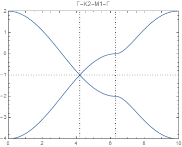

In the paper at the top right of page 8, they write ##\vec M_1 = \dfrac{2\pi}{a}(0, \frac 1 {\sqrt 3})##. But, to me, this looks like the expression for ##\vec M_2##. Shouldn't ##\vec M_1## be ##\vec M_1 = \dfrac{2\pi}{a}(\frac 1 2, \frac 1 {2\sqrt 3})##?
I'm able to reproduce figure 5(c) using the path ##\Gamma##-##K_2##-##M_1##-##\Gamma## with ##\vec M_1 = \dfrac{2\pi}{a}(\frac 1 2, \frac 1 {2\sqrt 3})##. However, I have to follow your lead and use ##\vec k \cdot \vec a_\nu## instead of ##\vec k \cdot \vec a_\nu/2 ## for the argument of the cosine function.

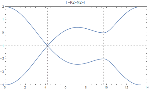

If I construct the band structure graph using the path ##\Gamma##-##K_2##-##M_2##-##\Gamma## with ##\vec M_2 = \dfrac{2\pi}{a}(0, \frac 1 {\sqrt 3})##, I get a graph that differs from 5(c). That's not surprising. I think this is the graph that your code would produce:
Path ##\Gamma##-##K_1##-##M_2##-##\Gamma## should also reproduce 5(c) since this path is equivalent to ##\Gamma##-##K_2##-##M_1##-##\Gamma##.

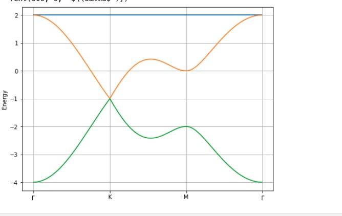

Am I going insane? When I run your code I get the following which looks correct to me. The only thing I had to change was
##k_K \rightarrow K##
##k_M \rightarrow M##
##k_Gamma \rightarrow \Gamma##

The middle part of your graph, K -> M, differs from Figure 5(c) in the paper. This is due to point M in the paper's graph corresponding to M1. But M in @randomquestion's code is M2.
The first and last segments of the two graphs are the same.
