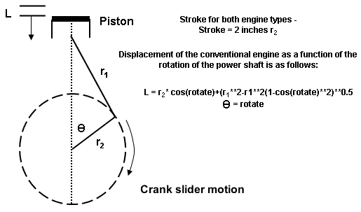

Dears, please help me:
How to Calculate the Required Force to Push the Car Engine Piston Down if I Want to Rotate my shaft in 1500rpm, My Piston Dia Is 50mm, Piston Hight Is 100mm, Piston Mass Is 1kg, My Engine Is 4cylender and 4stroke?
regards
ibrahim
