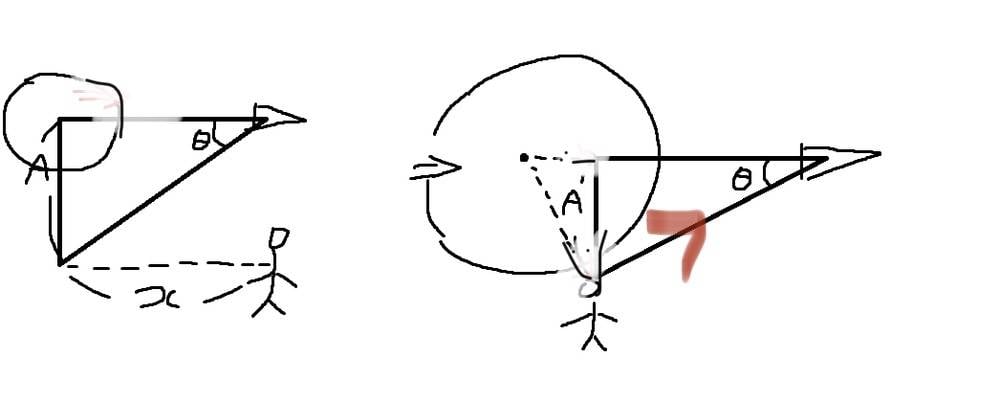

A jet flying directly over you at an altitude of 3000 m produces
a shock wave. If the angle of the shock wave is 42°,
(a) how long will it be until the sonic boom reaches you, and
(b) how far does the jet travel during this time interval?

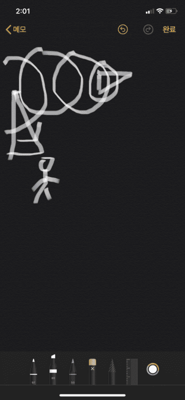

sin(θ)=vs/c
I draw this picture in order to solve this problem. My first attempt was find the hypotenuse of the triangle and divide it by the speed of sound wave.
d=a/sin(θ)
d=4483.43m
t=d/c=13.07 sec
However, I am not sure whether I did it correctly or not... It looks the time is too big as an answer...
I appreciate every help from you! Thank you!

I'm finding an answer to (a) that is less than 7 seconds. I think it helps to draw the shockwave cone (Mach cone) at the instant the plane is directly overhead as well as the cone at the instant the shockwave reaches the person on the ground.

The sound doesn't propagate along d. What is labeled d is the place that receives sound at the same time.
Simple cross check: You receive the sound from the airplane that's directly above you within less than 10 seconds. The airplane will be audible even before that.

Consider the moment at which you first heard the plane. Where was the plane when it made the sound you are hearing?
Likes Edel Crine
When it passed after me...?

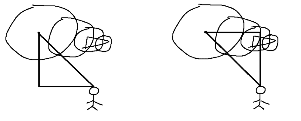

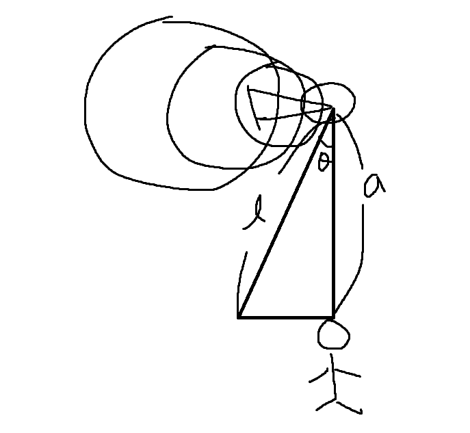

Here is my new guess...?

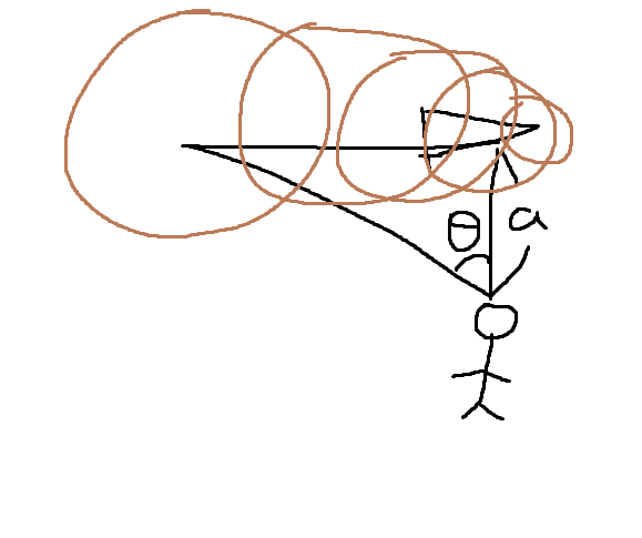

Your diagram is impossible to interpret. What is l?
The given angle of 42 degrees is an angle to the horizontal, not the vertical.
Look at the circles you have drawn. Each circle is expanding from a fixed centre, namely, the position of the plane when that circular wavefront was created.
Which circle will reach you first? How far has it expanded?
Likes Edel Crine
The largest one would reach to me first then other wavefronts..?
Where is the centre of the one that reaches you first?
It might help to think about the tangent line (the shock front) and which way it is moving. Backtrack from the time when the front reaches you to see where that bit of the front came from.

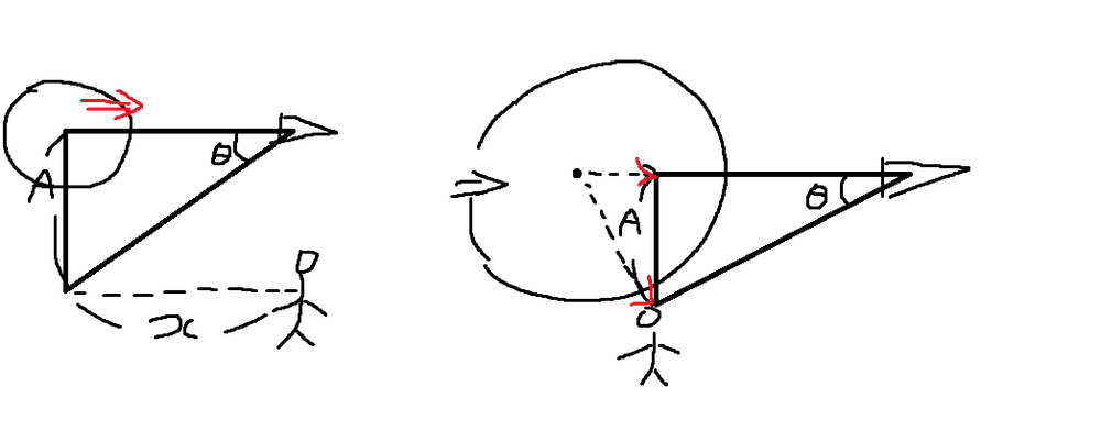

Sorry... I am doing my best to interpret this problem...

Mark on your diagrams which way the wave front is moving.
Likes Edel Crine
Edel Crine said:

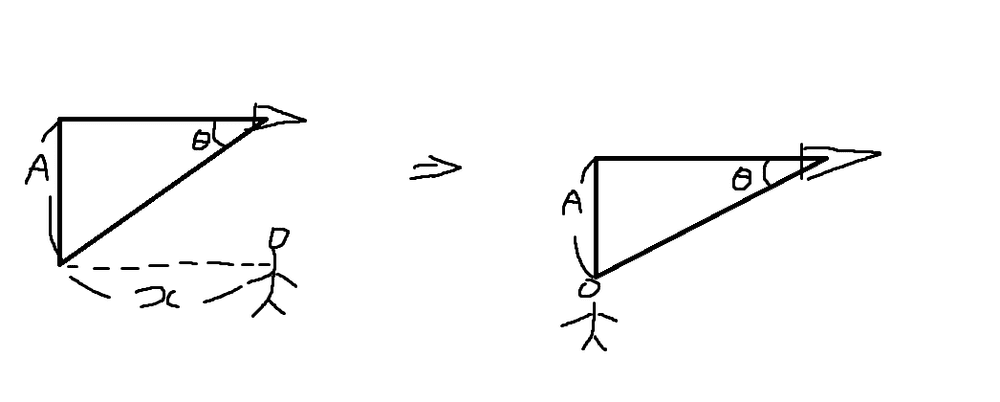

No, as I described, the wavefront of the shock wave is the tangent line to all the circles at each instant, i.e. the hypotenuse of the triangles above.
Which way does that line move over time?
Likes Edel Crine
In this way...? Or horizontally to the right...?

Edel Crine said:
View attachment 269355In this way...? Or horizontally to the right...?
Neither.
If you stand on the shore and watch a wave coming in at some angle alpha to the shoreline, which way does it look like the wave is advancing?
Likes Edel Crine
Am not sure, but...
Edel Crine said:
View attachment 269358Am not sure, but...
Yes.
Now, follow that line back from the person to find where the plane was when it emitted that part of the boom.
Likes Edel Crine

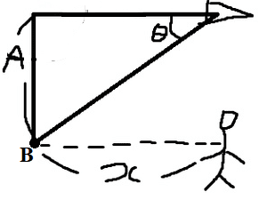

You drew the diagram
I added the point B which indicates where the sonic boom is on the ground. Think about the speed at which that point moves along the ground.
Can you use trig to find the distance x in terms of A?
Likes etotheipi and Edel Crine

TSny said:
This is not quite correct.
Hope I don't deflect the discussion too much. If so, ignore this post.
Tan(theta)=A/X?
Edel Crine said:
Tan(theta)=A/X?
Yes. So, you can find X.
Think of the plane as dragging point B along the ground. Can you figure out how much time it will take for B to reach the person?
