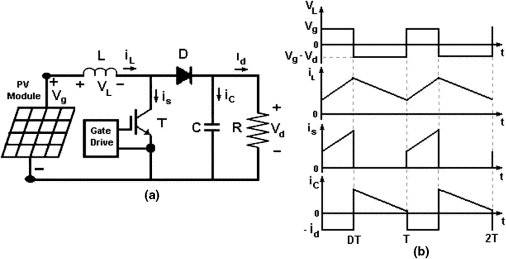

The average output current has to be over half of the ripple current.
So, the average output current has to be over half the ripple current.
Can you explain why this is?
Sure. Look at the 2nd plot down in the picture I posted. That shows the output current as a function of time. The ripple current is the peak-to-peak variation of the current, and the average output current is the DC average of that graph.
For continuous output current mode, you do not want to drop to zero output current at the bottom of the ripple current waveform. So if the average output current is at least half of that ripple current, the graph of the output current waveform never reaches the bottom axis (I=0).
The main problem with allowing non-CCM is that it complicates the feedback equations, and makes it harder to design a stable DC-DC converter circuit. Not impossible, of course, but it makes it harder, and constrains the performance of the circuit (either you add more circuitry to make it more expensive, or you settle for reduced regulator performance).

Using the circuit and component values originally posted, assuming that all components are ideal and that the square wave goes between 0 and +10 volt.
At high frequencies, the inductor acts as an open circuit to AC and the capacitor only charges to the average voltage of the square wave, or 5 VDC.
The current through the inductor goes continuous when the frequency of the square wave increases to a high enough frequency that the capacitor voltage drops to 5 VDC
THE FOLLOWING CALCULATES THE LOWEST FREQUENCY AT WHICH CCM OCCURS
For positive portion of square wave, di/dt = (voltage of square wave-C1 voltage)/Inductance
di/dt = (10-5)/0.0017 = 2940 amp/second
For 0 voltage portion of square wave, di/dt = (voltage of square wave-C1 voltage)/Inductance
di/dt = (0-5)/.0017 = -2940 amp/second
The current through the resistor is 5 volt/1000 ohm = 0.005 amp
For the average current through the inductor to be 0.005 amp, the peak current has to be twice this or 0.01 amp.
0.01 amp/2940 amp/second=3.40 microsecond that the square wave is at 10 volt.
Since the di/dt is the same for when the square wave is at 0 volt, the period of the square wave is 2 X 3.4 microsecond or 6.8 microsecond.
f = 1/period = 1/6.8 microsecond = 147 kilohertz
At frequencies below 147 kilohertz, the current through L1 is discontinuous.
At frequencies above 147 kilohertz, the current through L1 is continuous.
C1 never charges to a higher voltage than the peak voltage of the square wave.
When L1 is CCM, the output voltage is one half the square wave peak voltage.
(Tested this circuit using component values I gave previously and the two preceding statements are correct)
