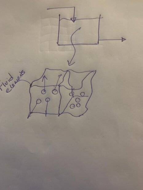

Residence time distribution- the time an entering particle spends in a system before it leaves. The residence time of molecules in a system is measured using tracers. The response for a system is recorded for some type of perturbation.
Consider $$ A+B \rightarrow C $$ and suppose we want to know the residence time distribution of molecule A. We select tracer T with similar properties to A which is non-adsorbing and non-reacting.
Assume a constant density system.

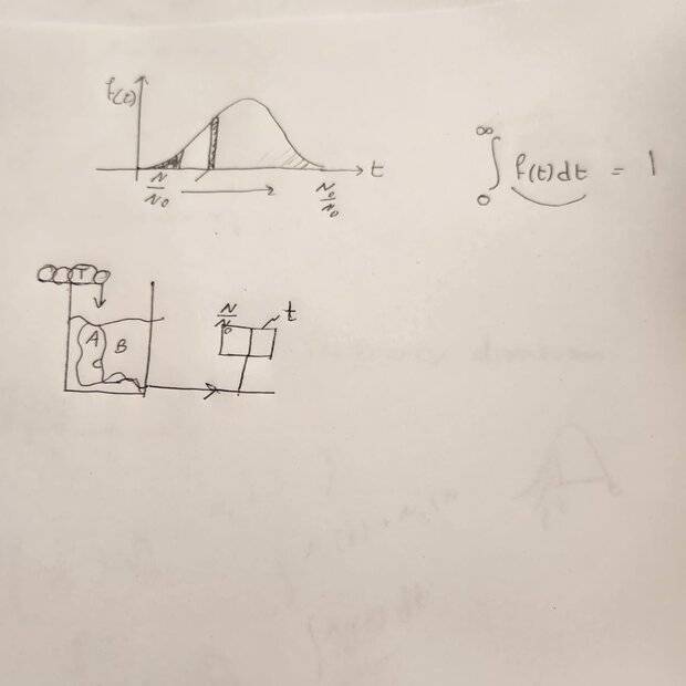

Lets say we inject a quantity N0 of tracer molecules in an instantaneous injection. The way I am thinking of it is as if a clock is attached to each molecule from the N0. Once a molecule leaves, the clock displays the residence time and there is a tracker of the proportion of N0 that leave the system at the same residence time. We can express N/N0 as a frequency or cumulative frequency distribution.$$(t,\frac{N}{N_{0}}) $$. However, it is physically impossible to measure for each time in an interval the proportions of molecules and I am not sure if the data collected is continuous or discrete. Since, if we repeat the same experiment any number of times a different distribution will be produced each time due to the randomness of molecular interactions, so we mathematically model the frequency distribution using a normal distribution function called the density function, f(t). How to interpret f(t)? Can I think of f(t) as the rate of molecules leaving the reactor at time t per N0. By integrating, we obtain all the molecules that have left the reactor which must equal to N0/N0=1. This corresponds to the area under a probability function. The number of tracer molecules N0 and N are not measurable quantities we divide by the volume of the vessel to get concentration C and C0.
I don't understand how the mathematics leads to what we are trying to determine: the time that molecule A spends in the reactor and remains available to react with molecule B to form molecule C.
What does this mean? You actually measure C and C0?
The central limit theorem is at work here
The number of tracer molecules cannot be measured directly under experimental conditions. Therefore, we divide by the volume of the vessel it is in to obtain measurable concentration quantities.
You divide "what" by the volume ("what" is something that you measure I presume?)
So you measure concentrations.....and infer numbers by multiplying by volume. I see now.
The Gaussian follows from the MVT mentioned above..read about this remarkably useful result.
After reviewing the CLT, I have realized that I have misinterpreted things. Instead of C(t)/C(t=0) the random variable of interest is the residence time t. According to the CLT, the distribution of the standardized sample residence time means approaches the standard normal distribution as the sample size approaches infinity. If I inject a fixed quantity N0 into the vessel and measure both the concentration and time. For each t I would measure C(t) and repeat this for many samples with a fixed injection of N0 then I would calculate mean from all the samples. $$ \frac{t(C(t_{1})+..C(t_{n}))}{nC(t=0)} $$ where t is fixed and C(t_{1}) is the concentration evaluated at t for sample 1 up t n. Repeat for different t we can measure form a distribution that distribution would be a standard normal. But I dont know the population mean residence time nor the variance of residence time.

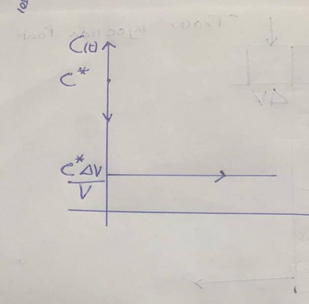

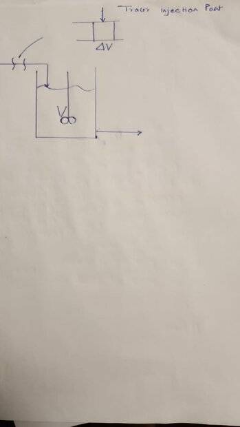

You have a chemical reactor of volume V with a feed stream having volumetric flow rate Q flowing through the reactor. What is the mean residence time in the reactor? You introduce a short tracer pulse of high molar concentration C* into the feed stream during the time interval ##-\Delta t/2## to ##+\Delta t/2##, where ##\Delta t## is short. How much tracer have you introduced into the reactor (in moles) essentially at time zero? If the reactor is well-mixed, what is the concentration of tracer exiting the reactor as a function of time? What would the concentration vs time graph look like if the reactor were not well-mixed?
$$ \frac{V}{Q}- \hspace{0.1cm} \text{time required to fill a chemical reactor of volume V.}$$
$$ C^{*}\Delta{V}- \hspace{0.1cm} \text{Number of moles that are present in the differential volume of the feed stream over} \hspace{0.1cm} \Delta{t} $$$$ \frac{C^{*}\Delta{V}}{V}- \hspace{0.1cm} \text{Oulet concentration}$$
The concentration in a well-mixed reactor is uniform and spatially independent when the moles are instantaneously and uniformly distributed throughout the reactor. Therefore, the concentration at the outlet will be equal to the concentration within the reactor. As a result, the concentration versus time curve will look something like this. In the case of a non well-mixed reactor the moles are not distributed uniformly throughout the reactor.
The volume of the reactor doesn't change. The number of moles of tracer entering the reactor is ##C^*Q\Delta t##. Because the reactor is well mixed the initial concentration of tracer in the reactor is $$C_0=\frac{C^*Q\Delta t}{V}=\frac{M_0}{V}$$where ##M_0=C^*Q\Delta t##
Your result for a well-mixed reactor is incorrect. The concentration balance of tracer in the reactor should be $$V\frac{dC}{dt}=-QC$$ where the right hand side represents the rate at which tracer is leaving the reactor and the left hand side represents the rate of change of tracer within the reactor. The solution to this equation is $$\frac{C}{C_0}=e^{-\frac{Qt}{V}}$$. This is also equal to the mass of tracer remaining within the reactor at any time divided by the initial mass of tracer in the reactor.
At what value of t has half the mass of tracer exited the reactor? What is the fraction remaining in the reactor at the mean residence time t = V/Q?
What would the fraction of tracerremaining in the reactor vs time look like for a plug flow reactor (no mixing within reactor0?
To understand why my result for a well-mixed reactor is incorrect is it because the system in consideration is a control volume and thus the concentration of tracer will vary with time (more tracer molecules will leave as time progresses) and that we are injecting once. So, the rate at which the tracer is leaving the reactor depends on how much tracer there is in the reactor?At what value of t has half the mass of tracer exited the reactor? What is the fraction remaining in the reactor at the mean residence time t = V/Q?
$$ \frac{C}{C_{0}}=0.5=e^{-\frac{Qt}{V}} \rightarrow -ln(2)=-\frac{Qt}{V} \rightarrow t=\frac{ln(2)V}{Q} $$ 50% of the mass will leave the system at the above time.
At the mean residence time t=V/Q $$\frac{C}{C_{0}} \approx 0.367 $$ At the mean residence time t=V/Q 36.7% of the initial mass remains in the reactor.
Since a plug flow reactor can be modeled as a series of infinitely thin plugs with uniform composition traveling in the axial direction, with each plug having the same composition as the ones before and after it (because a tracer is a non-reactive species), the outlet response of the system would start at 0. By the time it reaches the end of the reactor length, the outlet would record a step up equal to the initial concentration.
Not only that. After the initial tracer injection, the flow into the reactor is pure, and does not contain any tracer. So it acts to purge the tracer out of the reactor.
