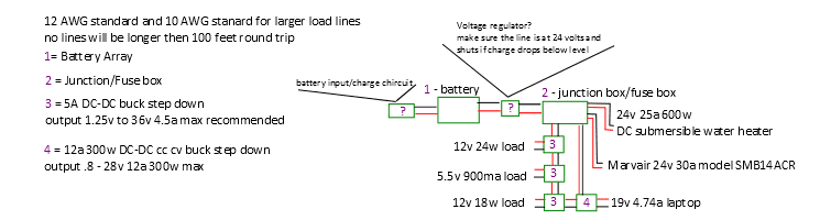

Residential DC power distribution, well that’s the end goal. The main question is about stepping down a 24v 4amp lead acid deep cycle battery bank to accommodate normal DC usage voltage. For example 24v 4amp too: 12v 1a, 5v 400ma, 9v .4a, 12v 2a. Was thinking of making adjustable outlets so they can be changed using a potentiometer to fit common device’s specs.

No, you would not use a linear voltage regulator for this application. You will be wasting most of your battery's power in making heat.
Instead, look into Buck DC-DC regulators. You can make them adjustable as well. :smile:

To achieve a basic type of DC power distribution (that’s flexible at the ports) I could wire these buck converter boards in parallel with the battery bank and it should work…right? All of these boards have a certain level of voltage regulation. Meaning, when the battery storage voltage fluctuation the buck boards compensate for the change. Think each board listed above has its own input voltage fluctuation specs. Just not sure what is going to happen to line voltage if all the boards are connected and drawing power at the same time.
Think in the thesis paper posted at the start of the thread he talked about having a voltage regulator/smoother close to the battery bank to ensure power lines have steady voltage. Would something like that be necessary to ensure proper distribution? As I understand it a lead acid bank can fluctuate by two or three volts, especially if charging during power consumption?

Now the only other thing you probably haven't considered is the large voltage drops you will get running low voltage DC around the house. You haven't said what sort of lengths of cable runs you will have on these lines ... but it is likely to cause additional problems as the current drawn is increased

Hi…good point about wire gauge, distance and amp being drawn effecting line voltage. Think this is a nice resource to get an idea of what is possible and to mess around with configuration. http://www.calculator.net/voltage-d...tance=20&distanceunit=feet&amperes=1&x=41&y=7
I’m not planning for any round trip distances longer then 150feet, MAX. I’m hoping the trick is keeping the system as a whole at 24v then stepping down when needed, not running any circuits dedicated to low voltage. More of having a circuit categories. Example: low-mid watt devices, mid-high watt devices, and dedicated circuits for one particular device. Planning the circuits based on usage and wattage of dedicated devices on them and that circuit’s ability to dynamically add/change common usage devices at will, aka plug/unplug move device. Does that make sense? I attached a drawing of what I’m thinking.

It would probably have to be a balance/dance of devices, distance and usage. Could something like in the drawing work correctly?
yup, I would have the highest current drawing devices the closest to the main power source
dropping off to the lowest ones at the ends of the cable runs
and yes, running 24V throughout and regulating down at the required points would be the best solution for keeping V-drops to a minimum :smile:
