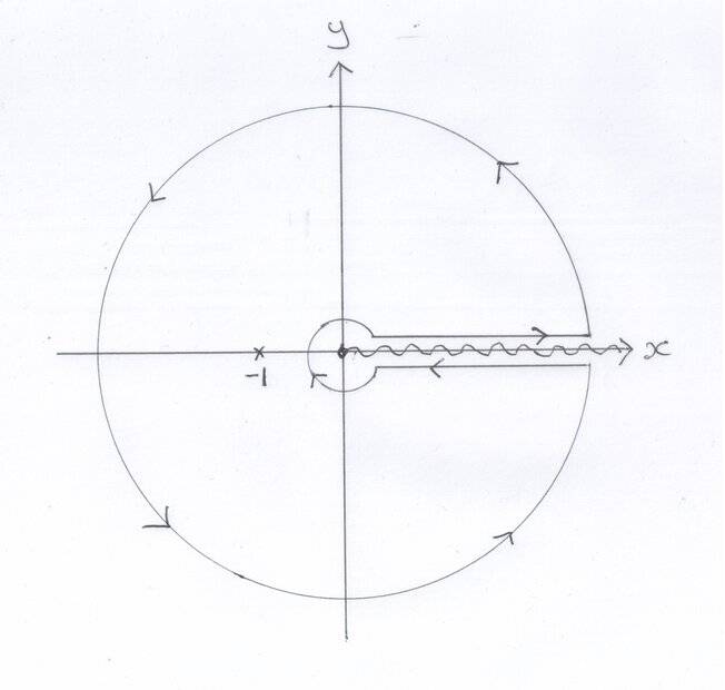

Use the Residue Theorem to show:
$$\int \:\frac{z^{\frac{1}{2}}}{1+\sqrt{2}z+z^2}dz=2^{\frac{2}{3}}\pi isin\left(\frac{8\pi }{3}\right)$$
for a keyhole contour where ##z=re^{i\theta }## and ##-\pi <\theta <\pi##

The path of integration is not clear to me. I can make a guess, but it is better if you spell it out. What is the multiplier 'a'? What is a "keyhole contour"?

Thanks for the responses. The integral is a closed contour integral (with a branch cut along the negative x-axis so the function is not multi-valued) but I couldn't find the correct symbol with the integral sign having a circle. The residue theorem states that in place of calculating the integral explicitly, it is equivalent to 2*pi*i*sum of residues.
This is an example:
