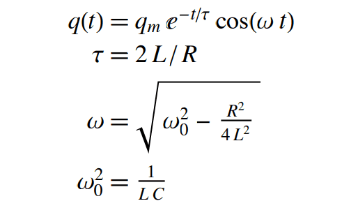

The output voltage, V_(out) (t) ‡ q(t) /C, effectively measures the charge on the capacitor as a function of time, where q(t) is an exponentially damped simple-harmonic oscillation:
a) Given that L = 0.05 mH, the square-wave frequency is 25kHz, and the ringing decays to 40% of its peak within half a square-wave cycle what is R?
b)If there are 17 cycles of the LCR ringing each half-cycle of the square-wave, what is C?
file attached is the equations
a)
the frequency : f=25*10^3
period = 1/f = 1/25*10^3 -0.00004
Period = 2L/R = 0.00004,
therefore R=2(25*10^-3)/(0.00004)=2.5
b) not sure how to incorporate the information of the 17 cycles into the first given equation. i think you have to use the first equation to find omega, then use omega to solve for omega_0 to then find C. also not sure if C is constant during the dampening of the LCR circuit.
Your first part is incorrect. You first need to find ## \tau ## where ## e^{-t/\tau}=.40 ## for ## t=T/2 ## where ## T ## is the period of the square wave. (The square wave is like a single step function applied to the circuit, but this step function gets applied repetitively so that the result can be observed much easier on an oscilloscope).

To give you some introductory information, the series RLC circuit has ## L \, \frac{d^2 Q}{dt^2}+R \, \frac{dQ}{dt}+\frac{Q}{C}=V(t) ##. With a square wave input, ## V(t)=V_o ## is constant (## V_o ##) for a half cycle. (Note that current ## I=\frac{dQ}{dt} ##). This differential equation has as its solution the form they gave you. That is basically the homogeneous solution. (There is also a ## sin(\omega t) ## in the homogeneous solution, but that is an extra detail that isn't needed to solve this. The solution to the inhomogeneous equation is simply ## Q(t)=CV_o ##, so the homogeneous solution is the only part that is oscillating. This occurs because of the resonance of the LC combination, and the frequency ## \omega ## a which it occurs is changed slightly by the resistor. With ## R=0 ## , ## \omega=\omega_o=\frac{1}{\sqrt{LC}} ##, where ## \omega=2 \pi f ##. For ## R \neq 0 ##, ## \omega=2 \pi f ## is given by the formula they give you. ## \\ ## I think your ## R=4.58 \, \Omega ## is correct. (I checked your arithmetic very quickly).## \\ ## For the next part, they essentially tell you what ## \omega ## is. ## T_1=(T/2)/17 ## with ## f=\frac{1}{T_1} ## and ## \omega=2 \pi f ##. From that and their formulas, you should b able to compute ## C ##. ## C ## is the capacitance of the capacitor, and yes, it is constant.

The damping is caused by the factor ## e^{-t/\tau} ##. The ## cos(\omega t) ## is an oscillation, as seen on an oscilloscope, that would be sinusoidal without the ## e^{-t/ \tau} ## term. With the ## e^{-t/ \tau} ## term, it becomes a damped sinusoid=the amplitude of the sinusoid gets exponentially smaller with time. The shorter ## \tau ## is, the quicker it gets damped. ## \\ ## ## \tau=2L/R ##. If ## R=0, ## ## \tau=+\infty ## so that ## t/ \tau=0 ## and there would be no damping.
