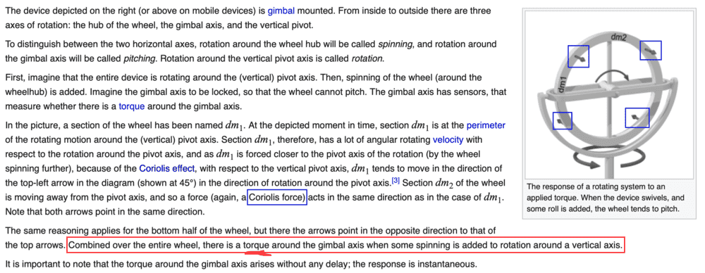

I must apologise for any confusion. Let me try again:
The wikipedia article that you linked was very informative. I'll use its description to explain my problem.
Please read the text in the attached screenshot.
After you've read the text, notice the red box in the bottom with the marked word 'torque'. THIS torque (as it is described in the article) is the one I'm looking for. This torque is my τy. The pitching torque.
The article states that the pitching torque arises from the Coriolis Force (marked with blue squares in the screenshot).
The only question I have now (after newly gained information) is how the Coriolis Force can be calculated. From the article that I posted before:
'Gyroscope Physics' (at this moment the website is down?)
- the Coriolis Force is derived to be:

Let us verify that we have common ground for discussion.
The Coriolis effect does not arise from looking at rotating objects from an inertial point of view. It arises from adopting a frame of reference that is itself rotating. This is often convenient because it means that we can look at a rotating object as if it were not rotating.
Let us bring that Wikipedia article in as text rather than as an attached image...
Wiki said:
To distinguish between the two horizontal axes, rotation around the wheel hub will be called spinning, and rotation around the gimbal axis will be called pitching. Rotation around the vertical pivot axis is called rotation.
This is a nice choice of terminology.
Wiki said:
First, imagine that the entire device is rotating around the (vertical) pivot axis. Then, spinning of the wheel (around the wheelhub) is added. Imagine the gimbal axis to be locked, so that the wheel cannot pitch. The gimbal axis has sensors, that measure whether there is a torque around the gimbal axis.
In order to invoke Coriolis, we need a rotating frame of reference. So we pick one which is locked to the uniform rotation of the device around the vertical axis. In this frame of reference the device is no longer rotating. It is just sitting there and spinning in place.
But this is a rotating frame of reference. In a rotating frame of reference, angular momentum is not necessarily conserved. We can have a changing angular momentum with no external torque. Or we can have constant angular momentum with a non-zero net external torque. The claim is that the latter is the case here -- we have a wheel that is rotating in place but only so long as a net external torque is supplied.
The task is to calculate the required external torque. Coriolis allows it to be calculated. It turns out to be a pitching torque.
F = -2 * m * ωs * vr
- where m is the mass of a point on the rotating disc of the gyro
- ωs is the spinning angular velocity
- vr is the radial velocity
Note that ωs is the angular velocity of your reference frame (around the vertical pivot axis), not of the rotating disc. And vr is the velocity component perpendicular to the vertical pivot axis. The Coriolis force and its lever arm around the pitch axis are not constant along the disc, so to get the total Coriolis torque you would have to use integration.
