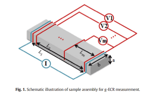

I think in my case I'd need to use a cuboid sample geometry as given by the figure.
Again, schematic shows a separation between the electrodes which draw current and the others that measure voltage. Like in the case of the four point probe system. However, schematic also shows that there are multiple probes placed on the various points along the sample length and the voltage is simultaneously measured between the starting point and all other points. I'd need to use a multiple probe system to do this measurement and I'm not sure is there something like four point probe system, but with multiple probes and where to buy it.
For this sample geometry, is resistance to specific resistance relationship given by the equation given in the main post? $$R = \rho \frac {l}{A}$$

That equation is only applicable for objects that have a parallel current flow.
You have a cylinder but have not identified the axial length, diameter, or ratio.
Please provide a sketch of your sample, with dimensions.
To get a parallel current in a short cylinder, the flat ends of the cylinder would need to be plated with a more conductive material, to connect the current electrodes to the area. Two points on the cylindrical surface could then be probed to measure the voltage.

I think in my case I'd need to use a cuboid sample geometry as given by the figure. View attachment 338270
I was thinking about the case when you have four probes in line, applied on the surface of the rectangular sample. Similar to this paper:
https://www.physicsforums.com/threa...esistance-relationships.1058518/#post-6984160
Look at the section about thick samples for correction factors.
