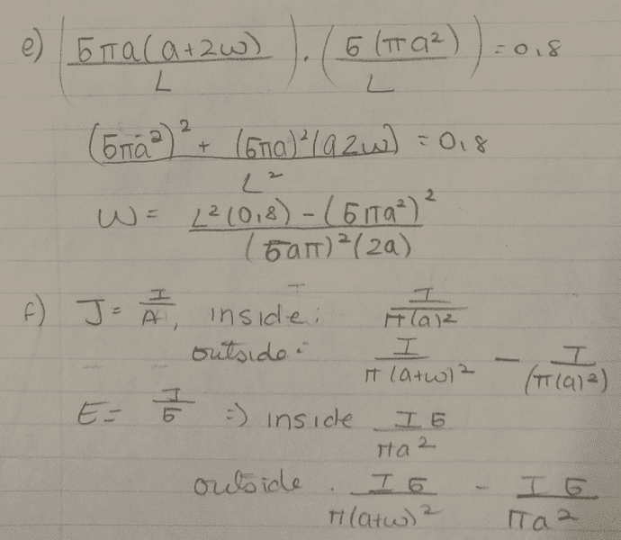

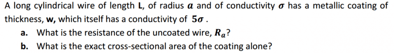

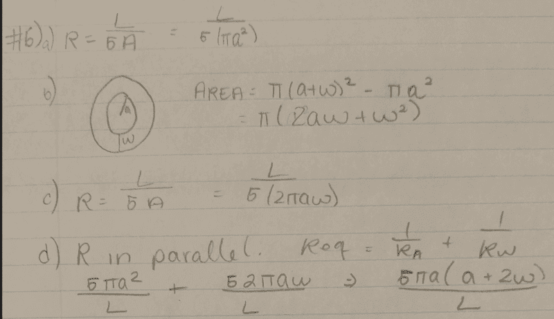

I attempted all of the parts:
You have d wrong. The formula you quoted is not quite right.Cocoleia said:think I did the right things for a-b-c-d
Ah I see it should be 1/Req. If I change that, will the following steps be right assuming I use that value ?haruspex said:You have d wrong. The formula you quoted is not quite right.
Your method in e) is right.Cocoleia said:Ah I see it should be 1/Req. If I change that, will the following steps be right assuming I use that value ?
If you read posts 2 and 3, you'll see that d) was wrong, and this led to the wrong expression in e.kuruman said:(a)-(d) look correct.
(e) is incorrect. You need to take the ratio as the question indicates, not the product.
How do I calculate it without assuming this? By the way, this isn't homework, I am just working on problems to prepare for an exam tomorrow.haruspex said:Your method in e) is right.
In f, you seem to have assumed all of I is in the inner wire when calculating the current density there.
One way would be to suppose the potential applied to the wire is V and compute what current would flow in each component.Cocoleia said:How do I calculate it without assuming this? By the way, this isn't homework, I am just working on problems to prepare for an exam tomorrow.
