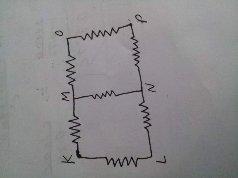

Find the resistance in resistor MN. Diagram is attached
in series circuit
R = R1+R2+R2+...Rn
in parallel circuit
[tex] \frac{1}{R} = \frac{1}{R_1}+\frac{1}{R_2}+\frac{1}{R_3}+... \frac{1}{R_n} [/tex]
I have no idea on how to get started. I was able to find the resistance between points K and L but I can't seem to make sense of how to draw a diagram for this. I just need a hint to get me started

Do all the resistors have the same resistance?
no all the resistances are different. I actually just wanted a better understanding of how to solve this kind of problem rather than solve this specific problem. The resistance in MN is 211 and was determined experimentally. I have to do a series/parallel analysis on the circuit to find the resistance in MN and see if the 2 resistances match within error range
Do you need the total resistance between nodes M and N?
Draw the M node at the top and the N node at the bottom - imagine you put a battery with the + terminal at M and the negative at N ans see where the current can go. There are three possible paths. See now?
ok I got it thanks
How to combine them depends on the two points you pick. You want the resistance between K and L, yes? clearly MO, OP, PN are in series, so combine those first. How do you think you should combine the net of that with MN? Then with KM and NL?
I actually figured it out. It turns out I had the diagram drawn a bit wrong. but I fixed it thanks to you help
