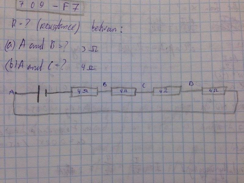

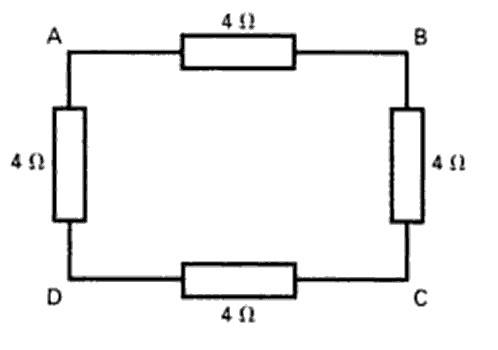

Calculate the resistance of the network shown below: (a) between A and B, (b) between A and C.
Answers: (a) 3 Ω, (b) 4 Ω
2. The attempt at a solution
(a) I would say that the resistance is 4 Ω between A and B.
(b) For A and C the resistance is: (1/4 + 1/4)-1 = 2 Ω.
In both cases the answers are wrong. What am I missing?
In (a) you treat the problem as if the three resistors along path ADCB were not there.
In (b) you treat the 4-ohm resistors along AC as if they were in parallel. Are they?
On edit: We cannot help you find out what you are missing if you don't show the relevant equations and how you used them.

In our case I don't understand whether it's a parallel one or a series one. It looks like a series.
Good. Now let's look at (a). Imagine a battery connected between A and B. In view of your answers to the first two questions, can you recognize which combinations of resistors are in parallel and which are in series?

This is how I see it:
They are all in series because as in my book example all the parallel ones are separated with black dots (in every example in my book, not only in this one). Like in the example 10 and 15 Ohm are parallel because of the two black dots. However, 4 and 2 Ohm resistors aren't parallel but in series, even though they are under 90 degrees to each other.
That's how I see it at this moment...
Your drawing is not correct. Imagine a battery connected at A and B. Start by drawing the square of resistors as given to you. Then draw one vertical line at point A going up and another vertical line at point B also going up. Draw black dots at A and B and a battery across the free ends of the vertical ends that you drew. Do you see what's going on now?

Something like this?
Almost. You need to erase one battery, say the one on the right and connect the negative terminal of the battery on the left to point B. Then you will have a complete circuit. Now imagine current starting at the battery. It reaches point A and splits in two parts. Which resistors are in series and which are in parallel?

Is this what you suggest?
Calculations:
(a) 1/R = 1/4 + 1/(4+4+4) so R = 3 Ohm.
(b) 1/R = 1/(4+4) + 1/(4+4) so R = 4 Ohm
Update: only one battery now here, I think this is what you meant.
You got it.
