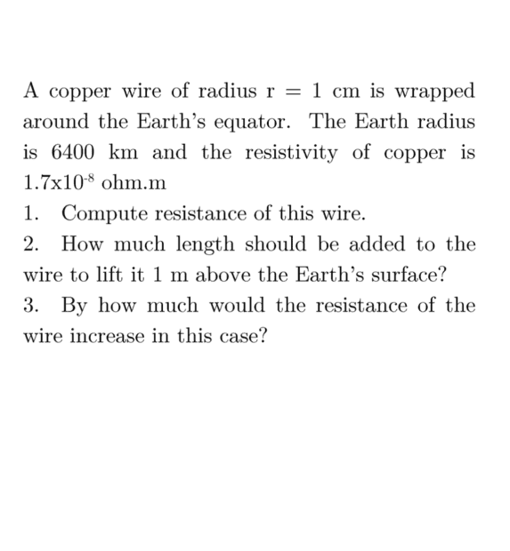

Homework statement in the image.
$$R=\rho\frac{l}{A}$$
$$l=2\pi r$$
Hey! I had a question about this problem.
I did (1) Using
$$R_{0}=\rho\frac{l}{A}$$
For (2) I assume the question means that the radius increases by a meter.
So I used $$\bigtriangleup L = 2\pi (r_{E}+1) - l$$
and then I used that L to find the new R. Then I said $$\bigtriangleup R = R-R_{0}$$
Does that seem right? This seems too simple to be right.
My final answer was:
$$\bigtriangleup R = 3.4 \cdot 10^{-4} \Omega$$

'Too simple' is not an argument ...
What could possible be wrong ?
I don’t see anything wrong with my steps. I think they are all logically sound. It’s more so that I’m paranoid and don’t want to lose points on homework for no reason really.
PF isn't in the business of stamp-approving homework. It wouldn't help anyone. You do your calculation, get a result and check it. Twice if you want, three times if you are paranoid :smile:
Have some faith in your work ... :wink:
I find it pretty hard to believe that adding a mere 6.28 m of wire is enough to lift it by 1 meter off the ground all the way around the Earth, but it does indeed.
It seemed unbelievable when I first heard this one, but the math bears it out.
##C = 2\pi r \Rightarrow \Delta C = 2\pi \Delta r## -- this is an equality due to the linearity of this function.
If ##\Delta r = 1 \text{ meter}##, then ##\Delta C = 2\pi \cdot 1 \approx 6.28 \text{ meters}##
