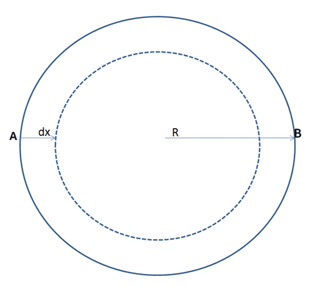

A circular disk of radius r and thickness d is made of material with resistivity p . Show that the resistance between points a and b (Fig. attached)is independent of r and is given by R=πp /2d
R= p L / A
where L and A are length and section area respectively .
I tried to use differential equations , but I always end up with ∞ or some indeterminate forms .

Isn't the cross sectional area is the surface area of dashed line circle ?

No, the cross-section should be orthogonal to "dx", and will look like a rectangle with height "d"...what is its width at any given value of x?
The length of a chord if you know the radius and the perpendicular distance from the chord to the circle center. This is a simple application of Pythagoras' Theorem.

You have a sign error, it should be [tex]w=2\sqrt{r^2-(r-x)^2}[/itex]...anyways, that looks good. Now, in order to make the integration easiest, try the substitution [itex]x=r(1-\cos\theta)[/itex] (which is exactly what you would have had if you'd set the problem up in cylindrical polars)

I got the same answer now which means that my problem was in considering the cross sectional area as a circle .

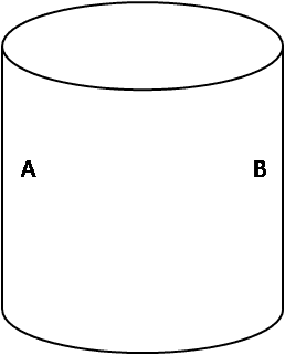

But I am a little confused , If you look at this example (b) ( hollow cylinder ) we considered the cross sectional area as surface area of cylinder . what is the difference ?
The current flow in both problems faces the same cross sectional area !
so why they don't be the same in our calculations ?
Is that because the voltage is applied only between points A and B in previous problem ?
The difference is that in example (b), the potential difference is applied to the ends of the cylinder, so the current flows down its length and the cross-section that is perpendicular to it is the circle/lamina.
In this problem however, the current flows from one side of the cylinder to the other (not lengthwise), and the cross-section perpendicular to it is rectangular.
