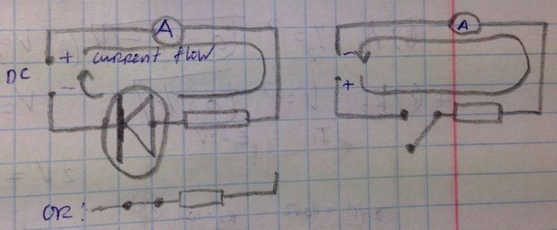

I would say the arrangement should be as follows:

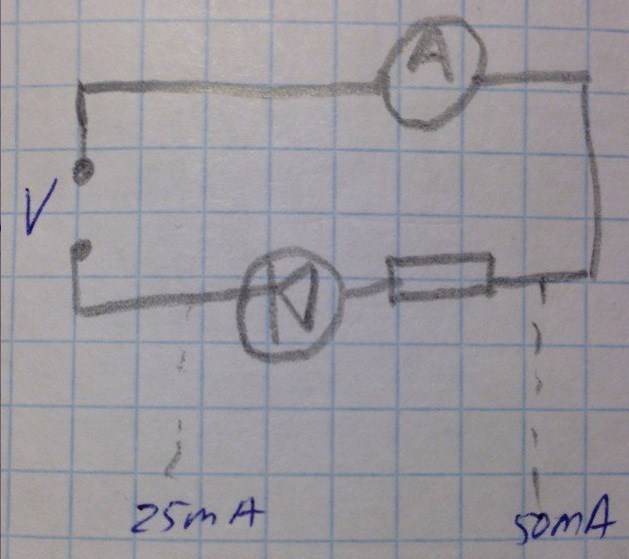

Since the diode consumes energy, therefore the current is smaller on its side. And current is higher on the side of the resistor.
But I am not sure about it. I am also not sure whether "when a PD of 1 V is applied across the terminals" it means that both the diode and the resistor have a PD of 1 V?
If 50 mA is flowing into one side of the diode and only 25 mA is flowing out, what happens to the "extra" 25 mA? Is charge accumulating on the diode? What effect would that have?

But isn't it what I did draw? A diode in series with the resistor?
Does that choice work for both polarities of applied voltage? Can any current at all flow when the diode is reverse biased?

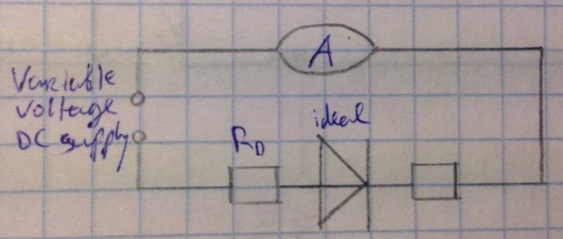

So I should change the current diode into an ideal diode? How does it look like? From here it looks like the variable voltage DC supply.
So it should be like this.
See the second paragraph of post #4. For an ideal diode current flows only in the forward direction.

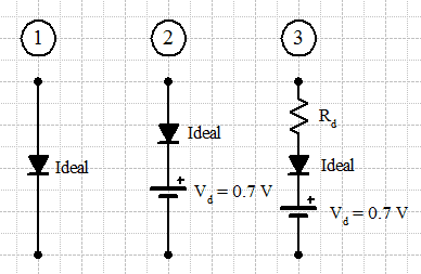

There are various levels of detail possible for modeling a real diode with ideal components. The "quick and dirty" way is to simply consider the diode to be an ideal diode (so it behaves as a simple one-way valve for current). The next level is to add in the forward voltage drop by placing a 0.7 V voltage source in series with an ideal diode. The next level up again is to add in the series resistance associated with the diode. You then have a series connection of three ideal components to represent a "real" diode.
Three levels of model for a simple diode
Here we are only concerned with modelling the diode's basic properties of conducting current in only one direction and having some forward resistance. That's just an ideal diode in series with a resistor. This combination replaces the diode symbol in your proposed circuit:

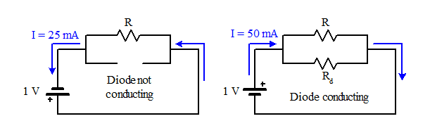

A simple diode model that exhibits resistance when conducting
So that "subcircuit" represents your real diode. You still need to connect this with another resistor in some fashion to create the circuit inside the box.

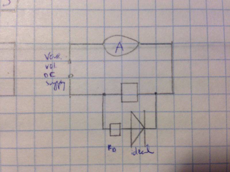

I think the ideal diode with it's resistor RD should be placed parallel to the resistor.
If current goes anti-clockwise, the ammeter reads 25 mA, since both resistors consume energy and the diode allows the current flow. If the current goes clockwise, the ammeter reads 50 mA, since only resistor consumes energy and the diode does not allow the current flow.
Yes, that looks like a viable circuit. Well done.

There are two cases to consider: Diode not conducting and diode conducting. In one case the resistance is lower than the other because the diode resistance is placed in parallel with the external resistor. Less resistance means more current. So it should be obvious how to assign the measured currents to the cases:
What's the value of the resistance in the first case?
What's the net resistance in the second case?
