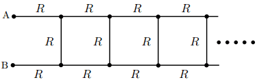

Figure shows a very long ladder where every part has a resistanse of R. What is the resistance between A and B if the ladder can be approximated to be semi-infinite (the ladder has a beginning but no end).2.The figure
3. The attempt
The first three resistances have a resistance of 3R the next step add 3R in parallel to R. The next step after that provides 3 more resistances in parallel with on of the resistances in step two.
Step 1: ##3R## [##2R+\frac {3R}{3}##]
Step 2: ##\frac{3R \cdot R}{R+3R}+2R=2R+\frac{3R}{4}##
Step 3: ##2R+\frac{3R}{5}##
Step 4: ##2R+\frac{3R}{6}##
Step 5: ##2R+\frac{3R}{7}##
There is a pattern here. Namely
##Rab=2R+\frac {3R}{2+n}## for n> 0 and n being integer.
The answere is 2.73 but i get 2.000... something for high values on n.
Please help me.

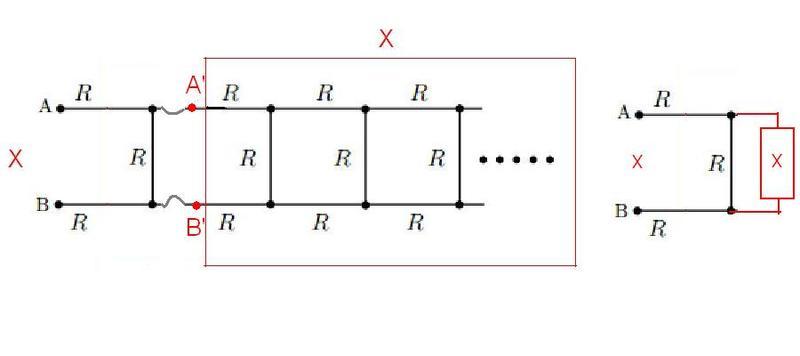

We think the way that the resultant resistance X does not change if one unit of the ladder is added or removed from the infinite number of units. See picture of the ladder and the equivalent circuit. Solve for x.
ehild

Let's say the total resistance of the circuit on the right is equivalent to a resistance M.
You can also say that when you add 3 resistors to that resistor M you make a circuit which again has an equivalent resistance M.
Solve for M. :smile:
Perhaps this approach could be called a recursive technique! :approve:

Evaluating the results, you have a sequence 3R, 2.75R, 2.733R ... They appear to tend somewhere.:biggrin: The differences get smaller and smaller. At the end, the difference between the last two elements of the sequence is so small that they can be considered the same.
If you have the nth term, the n+1th is Rn+1=2R+RRn/(R+Rn), and at the end you can consider Rn+1=Rn. What do you get for Rn?
ehild

##R_{ab}=R+R//R_{ab}+R \\ R_{ab}=2R+\frac{R \cdot R_{ab}}{R+R_{ab}} \\ R_{ab}(R+R_{ab})=2R(R+R_{ab})+R \cdot R_{ab} \\ R_{ab} \cdot R+R_{ab}^2=2R^2+2R_{ab}\cdot R+R \cdot R_{ab} \\ R_{ab}^2=2R^2+2R_{ab}\cdot R \\ 2R^2+2R_{ab}\cdot R-R_{ab}^2=0 \\ ##
Solve for ##R_{ab}## where ##R_{ab}>0##
##R_{ab}^2-2 R \cdot R_{ab}-2R^2=0 \\ R_{ab}= R \pm \sqrt{R^2+2R^2} \\ R_{ab}= R \pm R\sqrt{3}##
##R_{ab}= (1 + \sqrt{3})R ## since ## R_{ab}= (1 - \sqrt{3})R ## is undefiened.
Yey! :D It is the right answer.
Only the + sign gives valid solution. Rab can not be negative. But you have solved it! Congratulation!
The sequence of resistances, as you calculated them, converges very fast to (1+√3)R = 2.7320R. The fourth is 2.7321R already.
