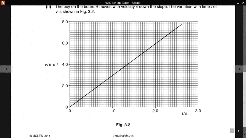

A boy on a board B slides down a slope. The angle of the slope to the horizontal is 30°. The total resistive force F acting on B is constant.
The boy on the board B moves with velocity v down the slope. The variation with time t of v is shown in Fig. 3.2.
Calculate the resistive force.
wsinA----?
Resistive force= WsinA
= 75 x 9.81 x 0.5
= 367.5 N
My answer does not match with the correct answer. How do you solve this?

Use the graph to determine the acceleration.
You didn't include the weight or mass of the boy and board in the problem statement .
What component of the weight is parallel to the incline ?

Find the acceleration.
a=(v-u)/t
a= 7.4/ 2.5 (the question asks us to calculate all the answers till 2.5s)
= 2.96 m/s^2
But then what? Do I use F=ma? With this formula the answer comes to 222N, but the answer is 147N.

What are you using for the net force?
Show your work.

I multiplied the acceleration I found with the mass of the boy:
F=75 x 2.96
= 222 N
Is this the net force or the force that opposes the boy?

That's the net force required for the boy and board to have an acceleration of 2.96m/s2.
What two forces combine to make that net force?

The resistive force opposing the horizontal component of weight and the contact force?
Yes for the resistive force. No for the contact force.
What does W⋅sin(A) result from? You seem to have abandoned it .

W sin A results from the weight of the boy, which is a force.
So the weight of the boy + the resistive force= the net force?
Then,
The resistive force= 222-367.5
=-145.5
On rounding off to 2 sf, it gives 150N, just like in the answer!
Thanks!
