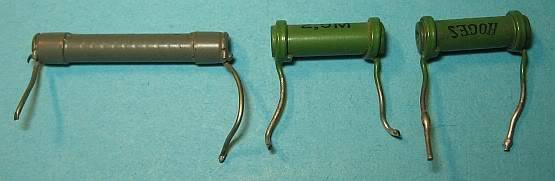

I'm sure you all have all seen resistors that are mostly cylindrical but flat on one side. So printing (likely silk screen) was a solved problem.
Picture? I don't remember this description...
I don't have any around. They are cylindrical with one flat side, which is printed. They seen to come mostly in pastels.
I don't remember that either.
Hmm, my Google Images search came up empty, so maybe they were very unique parts? Where do you remember seeing them? Inside an accelerator someplace? :wink:

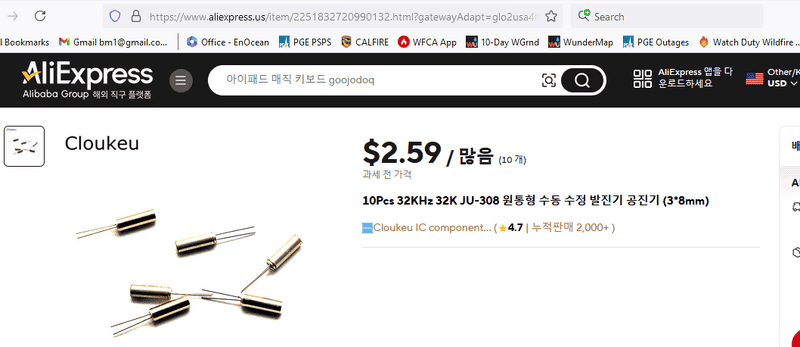

I think this was probably the reason, with the small diameter cylindrical shape being hard to print on at the time (especially with the coating material of the resistors). Capacitors were more disk-shaped, so easier to print on their mostly flat surfaces. I don't recall any caps with the same small radius shape as small-wattage resistors at that time.

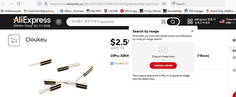

32kHz watch crystals were probably pretty common at the same time, and definitely were printed on. Was it because of the metal can material versus the ceramic-like material coating the resistors?

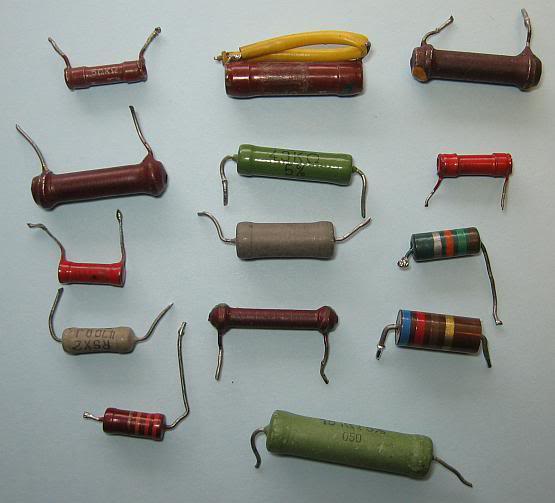

It did not start with color code. The oldest (I met with) were mostly printed.
By size, that time there were some smaller printed ones than banded ones. So I think size constraints does not apply as reason.
My guess: they lost on competition. The banded ones are with centered leads, the printed ones were often oriented.
In manufacturing, that means banded could be rolled around fast and easy => cheaper.
In supply, centered leads could be packed more compact.
In assembly, centered leads (bended on the fly during assembly) requires less attention and cheaper machinery.
The centered&printed ones still required attention on orientation to be useful.

Mostly detector readout. Nothing I had anything to do with designing, but I looked at a lot of failed boards. (Before replacing one, it is a good idea to look for signs of overvoltage - if the power supply is killing boards, you don't want to blindly replace them.)
They were precision (4 digits) and had a good number packed near each other on the board. ADC maybe? A discriminator?

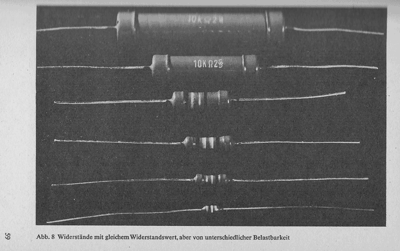

Resistors with common small power rating were too small for printing on them.
Source: book from 1976 "Einführung in die Elektronik", published by Jean Pütz (out-of-stock).
