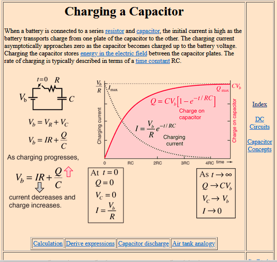

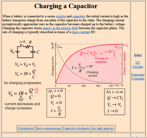

The relevant equation for the voltage on a charging capacitor in an RC circuit is:
$$V(t) = V_s (1- e^\frac{-t}{RC}) $$
Can you use that to figure out what the voltage is at the time specified, and translate that to the charge?
http://hyperphysics.phy-astr.gsu.edu/hbase/electric/capchg.html
