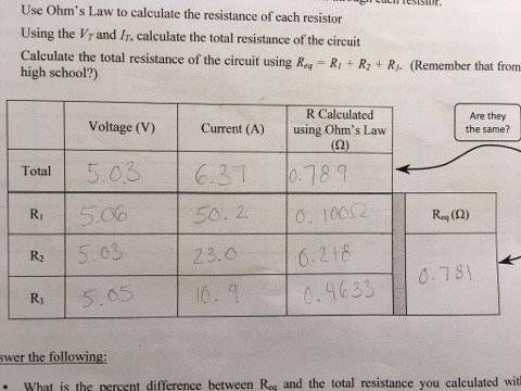

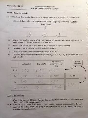

Hi guys!
(see my attached photo to better understand where I am coming from!)
So after some research, I've discovered that the current at different points in a simple series circuit is supposed to be the same value, and that the voltage is supposed to be different values.
I performed a lab on resistors in series the other day, and I believe my data is incorrect.
The majority of the data I got tells me that I may have set my circuit up as a parallel series - however the fact that the total measured current is not equal to the sum of the separate currents measured at each resistors conflicts with this. (see attached image of my lab data for clarity!)
Furthermore, due to the value of the total current as well as the value of the total voltage, the total R calculated using Ohm's law is equal to the Req that was calculated through adding the individual resistances up (which were also calculated through Ohm's law).
I am wondering, what did I do to obtain this kind of data information? As it does not conform what I would designate as a series circuit, nor a parallel circuit.
Does anyone have any idea what I have done to obtain this lab data? What kind of circuit did I create?
Thanks a lot in advance.
your attached image is VERY difficult to read
What is the battery voltage ?
are the resistance values given ... even at least one of them ?
Likes shmoop

Here is a zoomed in version of the photograph!
The supply was approximately 5 volts.
R1=100 ohms
R2= 220 ohms
R3= 470 ohms
Sorry about that!

Now that we have the resistor values I think I can see what you did in the experiment.
It looks to me like you started with the resistors in series and measured the overall current correctly (but forgot the current values were in mA not A).
For example the total resistance is 790 Ohms so the current should be about 6.37mA but you wrote down 6.37A. Then when calculating the total resistance you did R=V/I (which is correct method) but you used:
R = 5.03/6.37 = 0.789 Ohms
instead of
R = 5.03/(6.37 * 10-3) = 789 Ohms (very close to 790 Ohms).
Then when you came to measuring the current through each resistor you connected each resistor to the power supply on it's own, which is incorrect. So the voltage across each resistor was the same about 5.03V.
The currents should have been...
For R1... I = 5.03/100 = 50.3mA (You recorded 50.2A)
For R2... I = 5.03/220 = 22.8mA (You recorded 23A)
For R3... I = 5.03/470 = 10.7mA (You recorded 10.9A)
So again it just looks like you forgot the values were in mA.
Again this made all your resistance calculations out by a factor of 100. Your calculations should have given you..
R1 = 100 Ohms
R2 = 218 Ohms
R3 = 463 Ohms
These are all within tolerance.
Of course you should have left all the resistors in series and measured the voltage across each.

How did you calculate the resistance with those current values?
In a series circuit, the current value is supposed to stay the same, and the voltage value is supposed to vary.
That's what got me thinking that you didn't have all three resisters in series when measuring the current through each resistors . If you changed the circuit and connected each resistor on it's own to the power supply (or put them all in parallel) then the voltage would be the same each time and the current values would change. The calculated current values are very close to the figures you measured if you allow for the mA vs A error.
So using your data with the current corrected to mA...
R1 = 5.06/(50.2 * 10-3) = 100.8 Ohms
R2 = 5.03/(23.0 * 10-3) = 218.7 Ohms
R3 = 5.05/(10.9 * 10-3) = 463.3 Ohms
Which are close to the correct values.
Likes shmoop
  • #33
Yes, I believe you are very correct. I must have disconnected the series circuit in the process of attempting to measure the voltage drops.
Thanks a lot for your input!

You can read the resisters by their color codes or you can measure them one at a time, stand alone. That will help greatly. For resisters in series there are three important things to consider that your data has completely wrong:
1) The current through all resisters will be equal.
2) The voltage drop over any resister is proportional to the resistance.
3) The total voltage drop is the sum of the individual voltage drops across the resisters.
You should make sure that your measurements agree with these principles for resisters in series before you precede.
Likes shmoop
