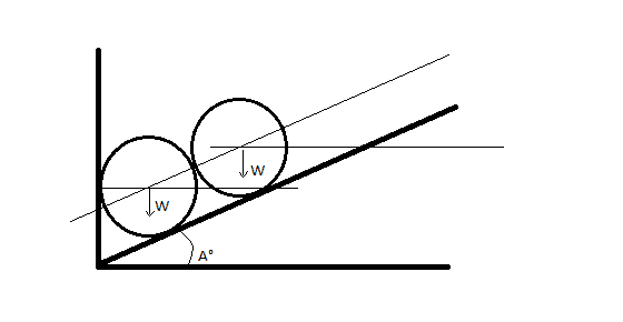

Two cylinders of equal radii each have weight W. They are at rest on a smooth slope of inclination A° to the horizontal, the lower of the two cylinders being in contact with a smooth vertical wall as shown in the diagram. Find, giving your answer in terms of W and A°, the magnitude of the force exerted by
a. the slope on the upper cylinder
b. the lower cylinder on the upper cylinder
c. the upper cylinder on the lower cylinder
d. the wall on the lower cylinder
e. the slope on the lower cylinder
OK so the first three are pretty obvious, a.= WcosA°, b.=c.=WsinA°
However I’m having trouble with d.
So d.=(normal contact force exerted on lower cylinder by slope resolved for the horizontal)+(normal contact force exerted on lower cylinder by upper cylinder resolved for the horizontal) = ((WcosA° resolved for the horizontal) + (WsinA° resolved for the horizontal)) = WcosA°sinA° + WsinA°cosA°=2WsinA°cosA°
However, the correct answer is 2WtanA°; where did I go wrong?

ok, draw a diagram of all the forces on the lower sphere (there are 4, and they all go through the centre of the sphere)
then, to find the reaction from the wall (d), add the components of all the forces in the direction parallel to the slope
what do you get? :smile:
(for e, choose a different direction)
are you sure i should resolve for the direction parallel to the slope and not horizontally?
try both, and see what you get :wink:
ok i figured out totally independently that i was forgetting the force exerted on the lower cylinder by the wall when calculating the normal reaction exerted by the slope on this cylinder, but if you can take some advice you were really not helpful here dude. seriously, you got me all messed up.

you specifically asked …
furor celtica said:
… where did I go wrong?
and i told you!
after that, you failed to show any work, even after i reminded you there were 4 forces involved :redface:
anyway, do you now see why you needed to resolve parallel to the slope? :smile:
