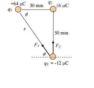

Resolving the electric force into x y components?
In summary, a 64 microC charge is located 30 cm to the left of a 16 micro C charge. The resultant force on a -12 micro C charge positioned exactly 50 mm below the 16 micro C charge is 2033 N.

A 64 microC charge is locate 30 cm to the left of a 16 micro C charge. What is the resultant force
on a -12 micro C charge positioned exactly 50 mm below the 16 micro C charge?
coulomb law f=k*qq/(r^2),resultant force,resolve into x and y component.
the first three steps are straightforward
first step
using Pythagoras rule gives s=58.3 mm and theta = 59.0 degree
the force b/w q1 and q2 using coulomb law i calculated
F13 = 2033 N.
similarly ,the force between q2 and q3, gives correctly
F 23= 691 N.
i am having trouble understanding these steps about resolving it into components.i need some revision here.
Fx = 0- F13 cos 59.0 (where does the zero come from?)
= -(2033 N) cos 59.0
which gives Fx = -1047 N
also
Fy = F23 + F13 sin 59.00(why add force 23)
= 691 N + (2033 N) sin 590
Fy = 2434 N
i can do the rest.
also it says
F13=2033 N ,59 degree north of West.
F23=691 Newton,Upward.
I don't get how these directions come and what they mean in the answers.
anyone help here.i am revising tons of questions and this is standing in the way or preventing me from proceeding .
Thank you

This is one of those threads where it all seems so straightforward that I might misunderstand where your difficulties lie, so bear with me.
The 0 represents the x component of the force between q2 and q3.
It looks like "F12" means the force exerted on q2 by 1, etc. In the y direction, you have both F23 and a component of F13.
F13 acts along the hypotenuse of the triangle. As you calculated, that is at 59 degrees to the x axis; specifically, 59 degrees N of W.
