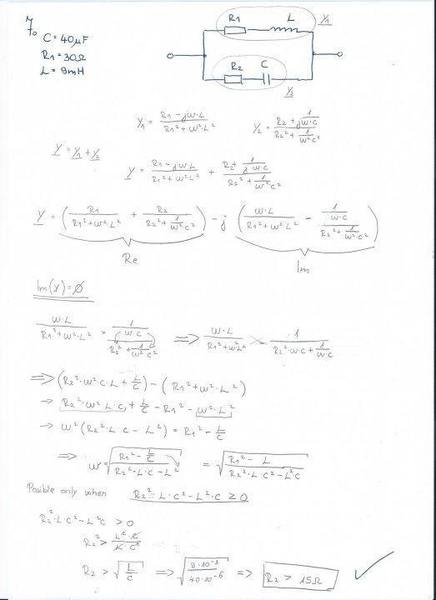

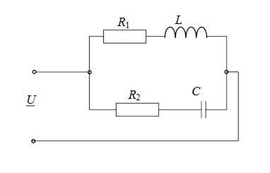

Resonance in parallel RL-RC circuit
In summary, the student is trying to find the resonance frequency for a circuit with resistors. They found that the resonance frequency is 1667 s-1 and the imaginary part of the admittance is always zero at a frequency of 790,57 s-1.
Kamen12
calculate R2, so the resonance is still posible ?
C = 40 μF
R1 = 30 ohm
L = 9mH
image : http://postimg.org/image/kampvczv5/
ω = 1/sqroot(L*C)
c = 1/(ω*C)
XL = ω * L
Z = (Z1*Z2)/(Z1+Z2)
My approach was to first calculate the resonance frequency ω = 1/sqroot(L*C) = 1667 s-1 than
XL = ω * L ; Xc = 1/(ω*C) == 15ohm, since they have to be the same to cancel out if I'm correct.
And at last got the R2 = 30ohm using the equation Z = (Z1*Z2)/(Z1+Z2) but the right answer should be R2 > 15ohm, so I don't know how to tackle this problem and I'm asking you guys for some advice/solution.
Thanks in advance !

Thank you BvU for the welcome and sorry for the hooker ads, didn't know how to post a picture :)
Thanks for the advice "LvW" I used the admittance this time and set the im(Y) = 0 just like you said and I solved the problem, I will post the picture of the problem solved for anyone looking for the solution.
Anyone looking for the basic equations used in this problem : https://en.wikipedia.org/wiki/Admittance
HQ picture of solution : https://mega.nz/#!tJ0mXKII!qWFYuqfMc8Bsr1RLLWfeaWbTHXtF_LeVgjp77pMnUE4

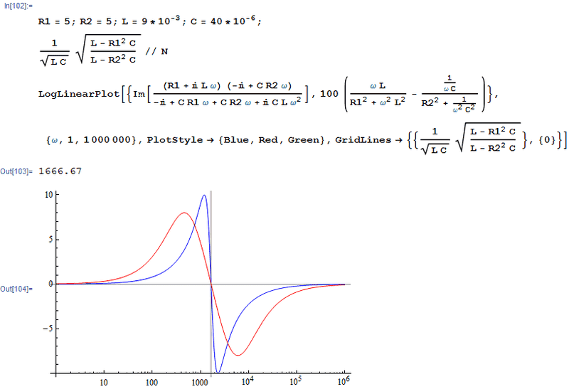

I suggest you sanity check your result before you hand in your answer.
Given these values:
C = 40 μF
R1 = 30 ohm
L = 9mH
What do you calculate for a frequency of resonance? What is the value of the imaginary part of the admittance at that frequency?

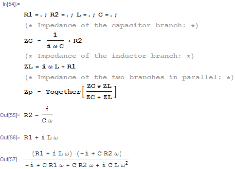

I derive an expression for the impedance of the circuit like this:
Now, for a sanity check, I plot over a wide frequency range my expression for the imaginary part of Z (blue) and Kamen12's expression for the imaginary part of the admittance (red) for values of R1=5 and R2 = 5. I see plainly that the imaginary parts do become zero at a certain radian frequency:

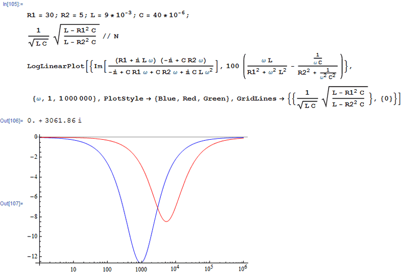

Now, let R1 become 30 ohms and let R2 remain at 5 ohms. A plot shows that the imaginary part is never zero, even though R2 is only 5 ohms. When R2 is 15 ohms, the situation is even worse; the imaginary part is never zero, so we have no resonance:
But, if for example, we make C = 4 uF rather than 40 uF, with R1=30 and R2=15 we do get a resonance:
It appears that with the given values for R1, L and C, there is no value of R2 which will give a resonance.
