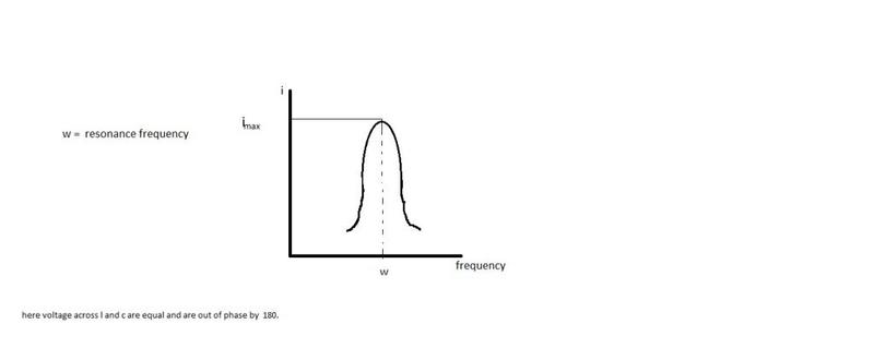

in series rlc circuit maximum voltage across inductor occurs at which frequency?
In the series rlc circuit current through the inductor is maximum at the resonance frequency.
But I don't know whether at resonance frequency maximum voltage occurs or not or it occurs at below or above resonance frequeny
The equations you will fill in under 2 will actually help you give the right answer.

@BvU
Since the voltage across inductor is equal to the voltage across the capacitor in magnitude, but out of phase by 180 degrees,
jwl*i = -(j/(wc))*i
Here i = current, w = frequency, c = capacitor and l = inductor
Does the maximum voltage across inductor occurs slightly below resonant frequency or or slightly above resonant frequency or at resonant frequency?
From my equation, I am unable to get the answer.

You need an equation for the current in terms of frequency.
If you connect a variable frequency AC generator to a series RLC circuit of emf Ug how do you calculate the current, and at what frequency is the current maximum?
How do you get the voltage across the inductor if you know the current flowing through it? ehild
