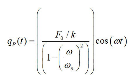

Suppose I take a 1DOF system (say spring, mass, and ignore damping) and apply an input force with a frequency close to the natural frequency. I can calculate the particular solution (ignoring homogeneous solution). For an input cosine forcing function of magnitude F0, here is the solution
k is spring constant and omegan=sqrt(k/m) is natural frequency and omega is the input frequency.
I can compute potential and kinetic energy and find that the total energy is capped.
Yet, I also have an intuitive feeling that energy is being added over time, due to the input forcing function (I cannot explain this feeling).
Also, if I look at the solution, it seems that the particular solution shows an "infinite" response immediately, upon the smallest input forcing function immediately after t=0

I think the misconception here is that when you are solving the mathematical equation, you are solving for the steady state, where the forcing input has been happening for an arbitrarily long time. When you are thinking about a physical situation, such as pushing a child on a swing, you are starting from zero, and your input is slowly changing the system.
Even if you had a system where the forcing frequency matched the system resonance, if you are starting from zero, there is a discontinuity at t=0 so you can't just solve the steady state equation.

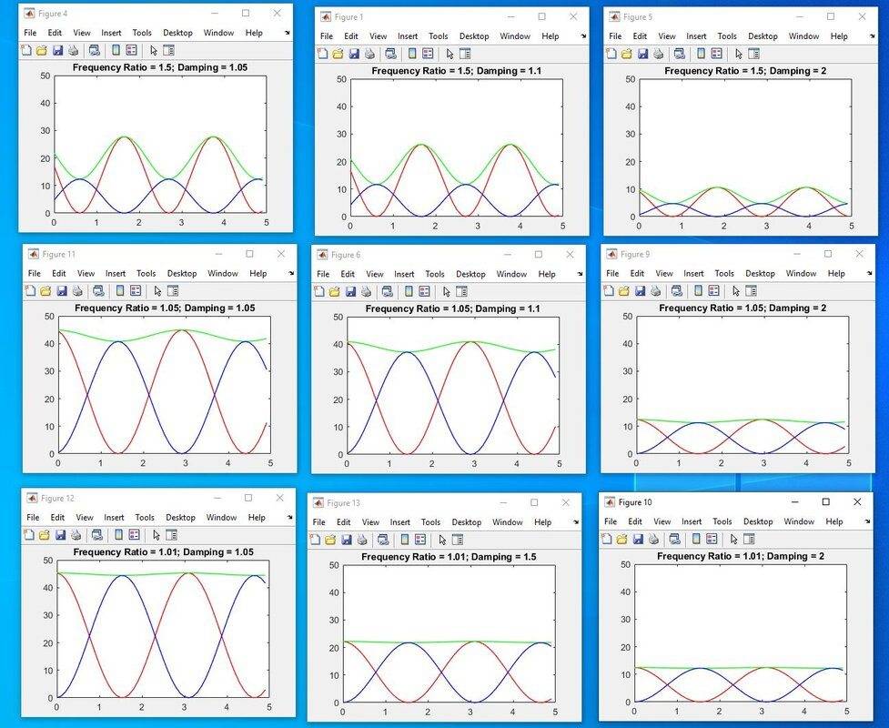

I am attaching some plots for the energy of a 1DOF mass/damping/spring system with harmonic input forcing function. The system starts from rest and I am ignoring transient response. I assume simple values for mass, damping and spring constant.
  • The red line is the kinetic energy (inertial)
  • The blue line is the potential energy (spring)
  • The green line is the sum of both of the above
In all cases, the total sum is not constant because of the harmonic forcing function that is constantly inputting energy.
  1. The first row has an input frequency ratio of 1.5 * natural frequency. As you move across the row, the damping increases.
  2. The second row has an input frequency of 1.05 times the natural frequency. Damping increases to the right.
  3. The third row has an in put frequency of 1.01 (approaching resonace) times the natural frequency.
So we can see that in all cases, damping extracts energy
However, it seems that as we approach the natural frequency, the sum of the kinetic and potential starts to be constant and impervious to the input variation.
Can someone discuss this? I can now accept that I should not be talking about "the system blows up."
But could someone discuss in words what is happening so I can get a more intuitive understanding?
I accept that in real system, approaching resonance with no damping, some assumptions (say the linear behavior of the spring, dashpot, etc) starts to break down.
Still... what is hapening?
