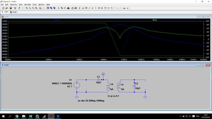

hello, collegues,
I need to calculate current on the right circuit, but I don't really know how.
I have the current in left circuit I and L1 L2 C1 C2.
I have tried to calculate this using impedance and ohms law. As Z2=Xc+XL, and U2=jwM, where M - mutual inductance
I think that I2 should be I2=U2/Z2=w^2 M C L I1 / (Lw^2 - c)
p.s. I know I1. Its U1/impedance
but i see from the simulator that I am wrong.. please, could you help me?
I add SH
I think we need the load impedance in the secondary circuit in order to calculate the current.
