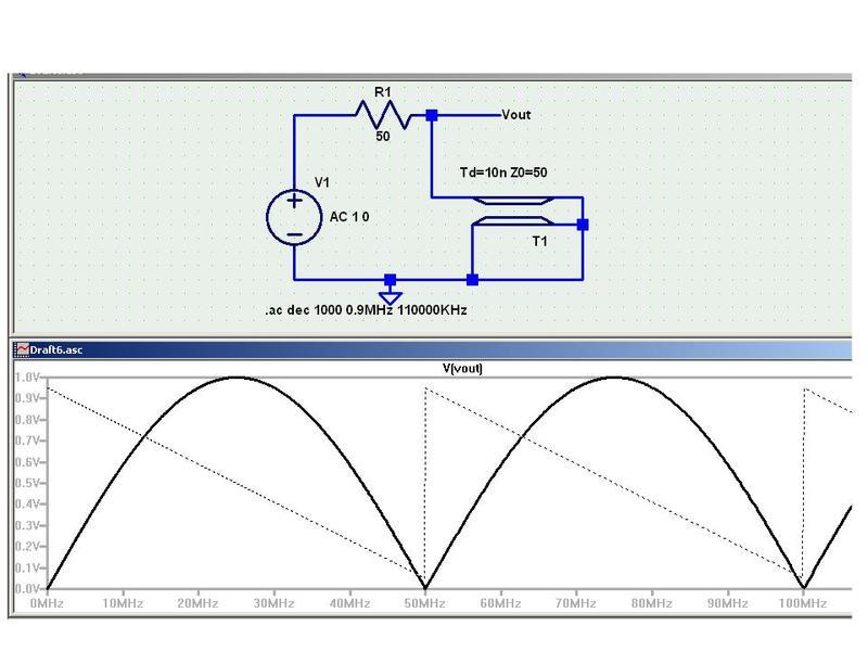

Does anyone know of a formula for determining the various resonant frequencies of 2 coaxial cylinders with radius a and b and height h? Thanks.

First, I assume you have a connector on one end. What kind of connector, and what is the impedance of the connecting cable? 50 ohms? 75 ohms
Second, is the other end of the coaxial tube assembly open or shorted?
third, the impedance of the coaxial tube assembly is
Z = [377/(2 pi)] Ln(b/a) where b is the radius of the larger cylinder.
Fourth, the one-way transit time is h/c where c= 3 x 108 meters per sec. h is the full wave wavelength. The full wave frequency is c/h. The lowest resonant frequency is the 1/4 wave frequency, c/4h. If one end is open, the other looks like a short. If one end is shorted, the other end should have an impedance Z2/(short resistance). A quarter wave line is an impedance transformer. If the Z of the coaxial tube is not the same as the impedance of the cable, then you have an impedance mismatch. See attached thumbnail for a 0 to 100 MHz frequency sweep of a 10-ns long coaxial 50 ohm line. The 10-ns line looks open at the 1/4 and 3/4 wavelength frequencies (25 and 75 MHz), and shorted at the 1/2 and 1/1 (50 and 100 MHz) wavelength frequencies
