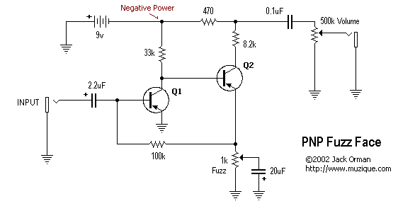

I've been looking for quite some time for some tutorial/video online explaining a working circuit. I mean, consider some simple analoge circuit, with resistors and voltage dividers, caps, maybe even transistors etc etc... If this circuit performs some understandable task, then what do these "helper components" do? I gather a lot is to do with ensuring the proper voltage and/or current "at" the various legs of the "more important" (active) components (transistors, mosfets, IC's etc). But while I understand there's a lot more to take into consideration than simply "powering on" transistors to make them do useful work, but what -- then -- do the resistors do for instance in the audio circuit ("fuzz") below?
The caps are there to prevent the DC powering the transistors "inside" the effect circuit from going along with the audio signal (which is AC) at the input and output. This could possibly damage the guitar and/or amp :-)

What is your main question? To be informed about a resource for explaining "simple circuits" - or do you want explanations for the shown circuit?
Nevertheless, I will provide some explanations:
1.) Starting with Q2: After supply voltage switched-on Q2 will open (pnp base negativ with respect to grounded emitter) allowing a collector current Ic2.
2.) The emitter current Ie2~Ic2 causes a negative voltage drop across the 1k resistor, which gives a bias voltage (through the 100k resistor) to the base of Q1.
3.) Hence, Q1 also opens and the current Ic1 produces a voltage drop across the 33k resistor - thereby reducing the base voltage of Q2 to a suitable fixed value.
4.) As a result, both transistors have a fixed operating point, which is temperature stabilized due to the 100k feedback resistor.
5.) Feedback works as follows: A temperature caused rising voltage across 1k increases Ic1 (more open) and increases the voltage drop across 33k. Hence, Q2 reduces Ic2 and works against the initial increase.
6.) The 2,2µF capacitor is for decoupling the dc gate potential (Q1) from the signal source; and the 0.1µF capacitor transfers a part of the ac output (amplified signal) to the load (This ac portion is determined by the output voltage divider 8.2k/470 Ohms).
7.) There is another capacitor: 20µF. It is the task of this capacitor to bridge a certain part of the 1k feedback resistor. As a result, we have the full 1k resistance for DC feedback (bias point stabilization) but only a part of this resistance for ac feedback. This is very convenient be cause we can tune the amount of ac feedback. Strong ac feedback is good for linearity (THD) but reduces the gain to a value that is (perhaps) too small. Thus, we can find a good trade-off between signal quality and gain.

Does this help?
