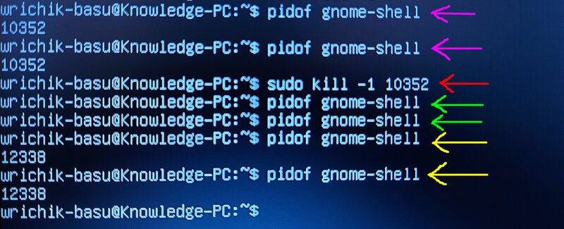

I did some testing, and this is what works (at least for me, Ubuntu 20.04):
  1. Went to TTY3 by pressing Ctrl + Alt + F3
  2. Logged in as current user.
  3. Executed sudo killall -1 gnome-shell
  4. Return to GNOME by pressing Ctrl + Alt + F2
How I knew it worked:
  • None of the applications that were open, were closed. Unsaved changes still existed.
  • I noted down the process ID of gnome-shell before and after the above steps. It had changed.
Note that it might take some time for GNOME-shell to restart. It seems that it is restarted by the system itself. To check whether it was restarted, you can check the PID of gnome-shell before and after killing it:
The pink arrows show the PID of GNOME before killing it. The kill command is highlighted by the red arrow. As indicated by the green arrows, just after killing, the PID is not returning anything, as GNOME had not started yet. Once a PID is returned (yellow arrows), it is safe to return to the GUI by pressing Ctrl + Alt + F2.
