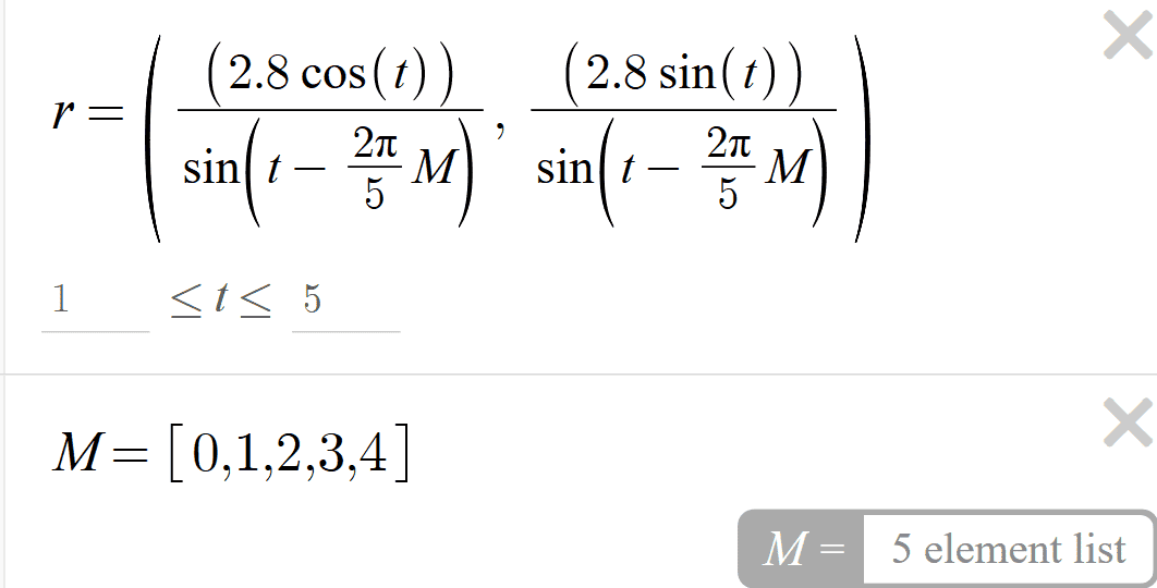

Hello. I have graphed a rose curve on Desmos using a parametric point, the equation looking like this:
However, I want the graph to be limited so that only values within the circle r=3.45 and r=9 are shown. I have tried using the curly brackets {3.45 <= r <= 9}, however this returns an error "You cannot multiply a point by a number". I have spent several hours searching for a fix to this, but to no avail. The built-in "t" restriction does not restrict the graph in this way, rather it deletes parts of it if the range is not at least 4. If anyone can help me restrict this function in such a way as to only show values within those circles, that would be very kind. Thank you!

Hi Plasma, welcome to MHB! (Wave)
I think we need to split up the domain into 10 pieces to do it in Desmos.
That is, we need:
$$\frac{2\pi}{5}M+\arcsin\frac {2.8}{9} < t < \frac{2\pi}{5}M+\arcsin\frac {2.8}{3.45}$$
and:
$$\frac{2\pi}{5}M+\pi-\arcsin\frac {2.8}{3.45} < t < \frac{2\pi}{5}M+\pi -\arcsin\frac {2.8}{9}$$
We can do it in Desmos by for instance duplicating the formula 10 times with different restrictions on $t$.
At this time I don't see another way to do it more compactly with Desmos.

Thank you so much! I don't want to ask too much, since you've already helped me tremendously, but is there any way you can sort of explain how you got those restrictions / how to use TikZ for multiple equations? What I'm trying to accomplish is plotting several "stars" and creating a constellation using a graphing software. Otherwise you've been a lifesaver.
No problem at all.
You have:
\mathbf r = \left(\frac{2.8\cos t}{\sin(t-\frac{2\pi}5M)}, \frac{2.8\sin t}{\sin(t-\frac{2\pi}5M)} \right)
= \frac {2.8} {\sin(t-\frac{2\pi}5M)}\left(\cos t, \sin t \right)
Your formula means that the magnitude of $\mathbf r$ is:
$$r = |\mathbf r| = \frac{2.8}{\left|\sin(t-\frac{2\pi}5M)\right|}$$
And we want $3.45 < r < 9$, so let's solve:
3.45 < \frac{2.8}{\sin(t-\frac{2\pi}5M)} < 9
\quad\Rightarrow\quad \frac{2.8}{9} < \sin\left(t-\frac{2\pi}5M\right) < \frac{2.8}{3.45} \\
\quad\Rightarrow\quad \arcsin\frac{2.8}{9} < t-\frac{2\pi}5M < \arcsin\frac{2.8}{3.45}
\quad \lor\quad \pi - \arcsin\frac{2.8}{3} < t-\frac{2\pi}5M < \pi - \arcsin\frac{2.8}{9} \\
\quad\Rightarrow\quad \frac{2\pi}5M + \arcsin\frac{2.8}{9} < t < \frac{2\pi}5M + \arcsin\frac{2.8}{3.45}
\quad\lor\quad \frac{2\pi}5M + \pi - \arcsin\frac{2.8}{3} < t < \frac{2\pi}5M + \pi - \arcsin\frac{2.8}{9}
To be fair, I've left out some intermediate steps.
After all, I have no idea what your level of understanding of trigonometry is.
Either way, please let us know if any of these steps are unclear.Btw, to create a 5-pointed star constellation with TikZ, we can do:

This makes sense to me, other than one small thing. I know it's necessary to have two restrictions, and I understand how you got the first one, but how did you get the second one? Other than that everything else works beautifully in Desmos. Truly, thank you :)
What do you mean by 'the 2nd one'?
I'm guessing you mean $\sin x=a \Rightarrow x=\arcsin a \lor x =\pi-\arcsin a$?
If that's the case, it follows from using the so called unit circle.
\begin{tikzpicture}[scale=3]
\draw circle (1);
\draw (-1.2,0) -- (1.2,0);
\draw (0,-1.2) -- (0,1.2);
\draw (0,0) -- node[above left] {1} (.86,0.5) -- (0,0.5) node[above right] {$a=\sin x$} -- (-.86,0.5) -- (0,0);
\node at (10:0.3) {$x$};
\node at ({180-10}:0.3) {$\pi-x$};
\end{tikzpicture}
That is, the solution to $\sin x =a$ is $x=\arcsin a \lor x =\pi-\arcsin a$ assuming $0\le x <2\pi$.
After all, there are 2 angles that yield the same sine.
