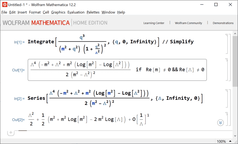

Explicitly writing out the result of the angular-integration step you describe gives:$$\intop_{\mathbb{\mathbb{R}}^{4}}\text{d}^{4}q\,\frac{1}{(q^{2}+m^{2})\left(1+\frac{q^{2}}{\Lambda^{2}}\right)^{2}}=2\pi^{2}\intop_{0}^{\infty}dq\frac{q^{3}}{(q^{2}+m^{2})\left(1+\frac{q^{2}}{\Lambda^{2}}\right)^{2}}$$Now if you google "Feynman integration tricks" or "Feynman parameterization" you can doubtless find a clever method or three for manually evaluating the semi-infinite integral over ##q##. But as for me, I find it much quicker to open Wolfram Mathematica, feed it the integral (which evaluates in a few seconds) and then power expand around ##\Lambda=\infty##:
renormalize said:
Explicitly writing out the result of the angular-integration step you describe gives:$$\intop_{\mathbb{\mathbb{R}}^{4}}\text{d}^{4}q\,\frac{1}{(q^{2}+m^{2})\left(1+\frac{q^{2}}{\Lambda^{2}}\right)^{2}}=2\pi^{2}\intop_{0}^{\infty}dq\frac{q^{3}}{(q^{2}+m^{2})\left(1+\frac{q^{2}}{\Lambda^{2}}\right)^{2}}$$Now if you google "Feynman integration tricks" or "Feynman parameterization" you can doubtless find a clever method or three for manually evaluating the semi-infinite integral over ##q##. But as for me, I find it much quicker to open Wolfram Mathematica, feed it the integral (which evaluates in a few seconds) and then power expand around ##\Lambda=\infty##:View attachment 331395
Unfortunately Mathematica is only useful if you need to find the result or verify that it's true, but I don't need that. I already know that the result is true, I need to find out how to get there.
I'll try Feynman parameterization
