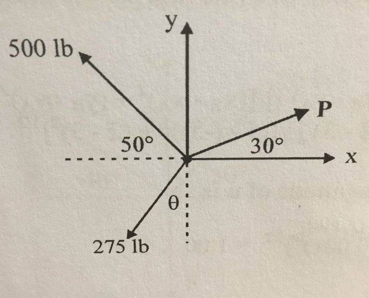

The Resultant of the system of forces shown is R = 425 j lbs. Determine the possible values of P and Θ.
R = F1 +F2+P
I ended up with two equations, one in the "i" direction and one in the "j" direction. I think you have to use the quadratic formula because I know that you will get two values for P and two values for Θ. Thanks!

The Problem is to find P and Θ. You will need to refer to the figure I attached on the original post. I get two equation but then I can't get past that point.

If you take the original force diagram and decompose the vectors shown into components, you should obtain two equations in P and θ. You know the x-component of the resultant is equal to 0, while the y-component must equal 425 lbs. Further algebraic manipulation yields and equation in sin θ and another in cos θ. By squaring and adding these two equations together, one can use the Pythagorean relation to eliminate θ, leaving a quadratic in P, which of course gives two values as solutions.
By substituting these values of P back into one of the earlier equations involving θ, you can obtain a pair of angles which are also solutions, but only one angle will work with a given solution to P, while the other angle works with the other solution to P. This is why there are four answers given.
